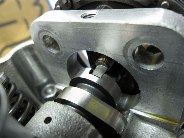

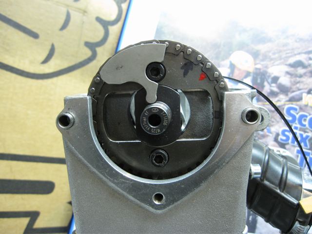

Bob,
A friend sent me some pics. One can clearly see the spring yet not the clip. It surely goes on the backside of where the shaft enters the cam.
These are in the normal running position, kicker lobe not engaged.
All said, I think you may have to remove the cam to get things back in situ.
MC
