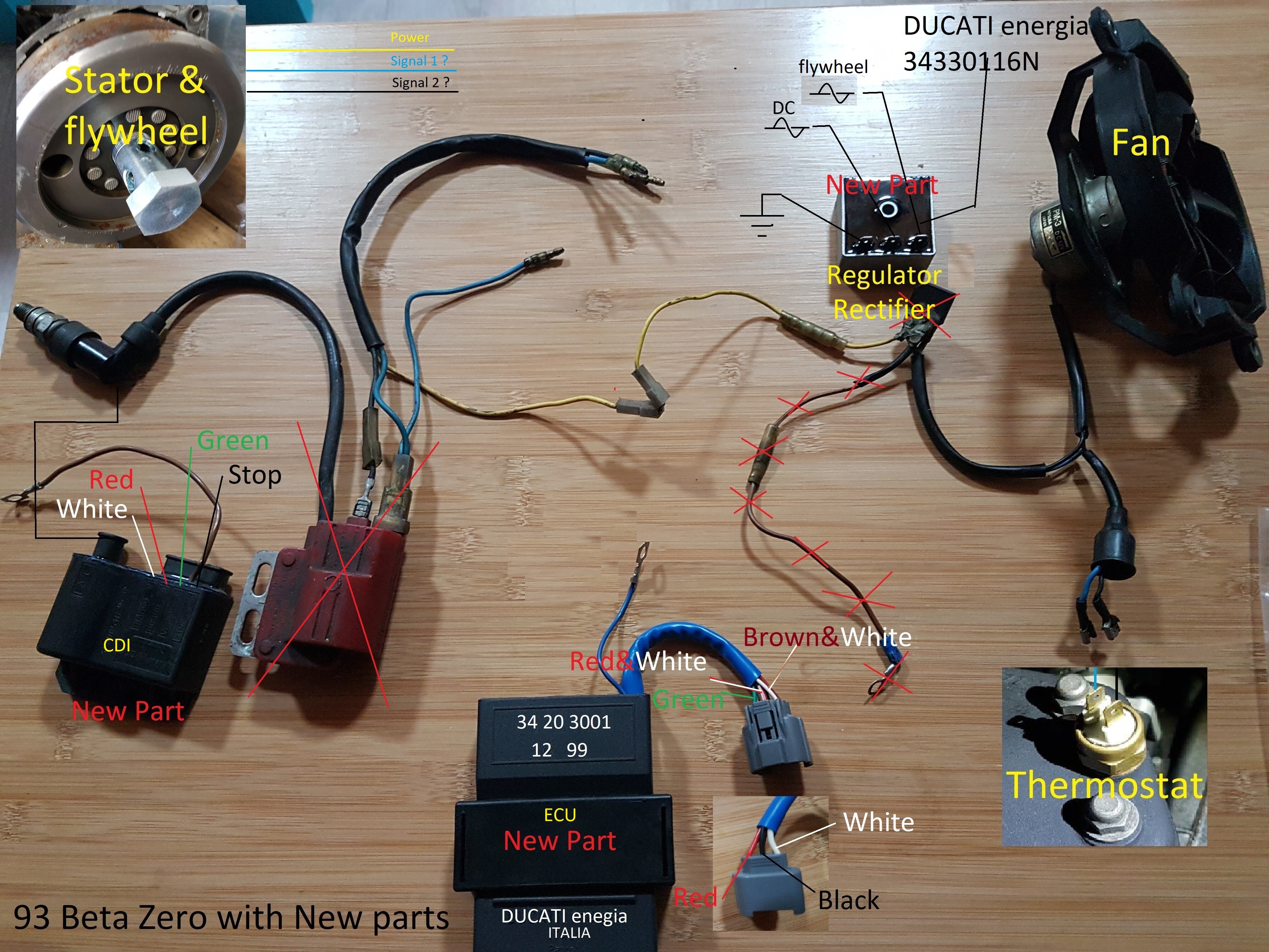

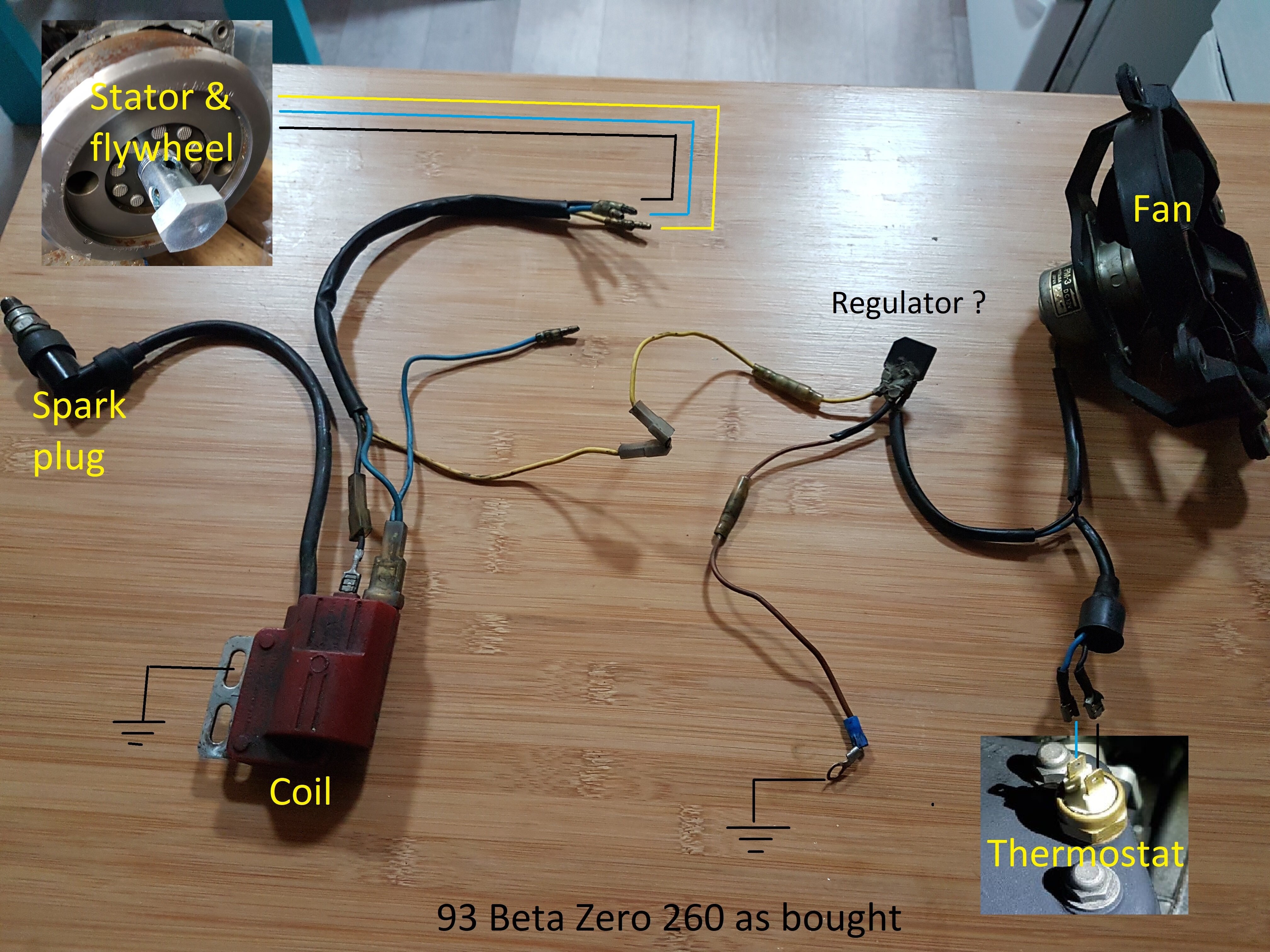

  1. Hi Everyone Yeah naah naah, after some more poking around still no fire in the wire. The GasGas Diagram was helpful but still no flash. I think I'm just gonna try to get a full replacement system, Any suggestions on where to shop? Lots of aftermarket systems on the interweb but I didn't find Beta stuff. Thanks Eddy
  2. jackyma09 started following EddyCox17
  3. Hi, I have a Beta zero that came in boxes. After attempting to get spark I concluded I didn't have all the bits. So I bought some bits over the old web!! but they don't look right and I still can't seem to get a spark. I have power from the magneto on the yellow wire and I guess the black and blue are signals. .What am I actually looking for to get the system complete. Or is there a brand new of the shelf replacement? As it seems motoplat have flatlined? I would rather buy a system that works with that flywheel and stop struggling. Any help appreciated Eddy Cox
