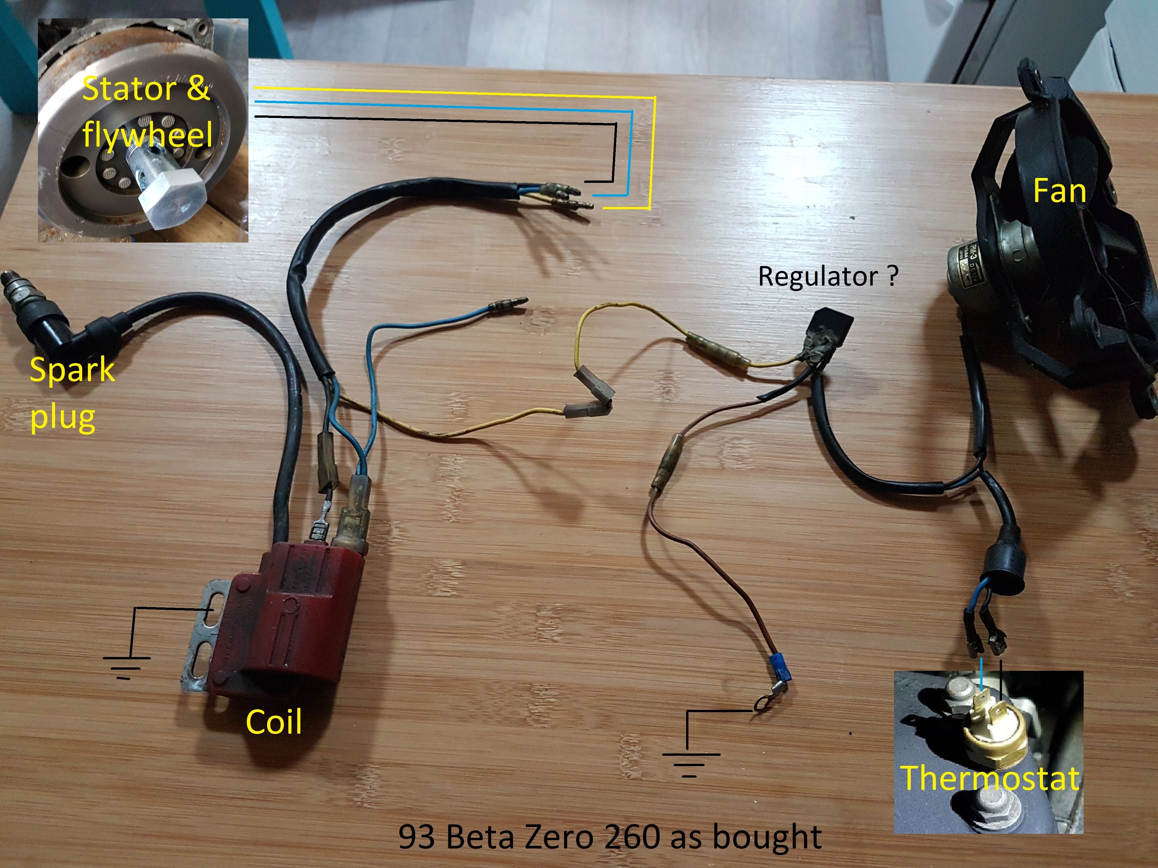

I have a Beta zero that came in boxes. After attempting to get spark I concluded I didn't have all the bits. So I bought some bits over the old web!! but they don't look right and I still can't seem to get a spark. I have power from the magneto on the yellow wire and I guess the black and blue are signals.
.What am I actually looking for to get the system complete. Or is there a brand new of the shelf replacement? As it seems motoplat have flatlined?
I would rather buy a system that works with that flywheel and stop struggling.

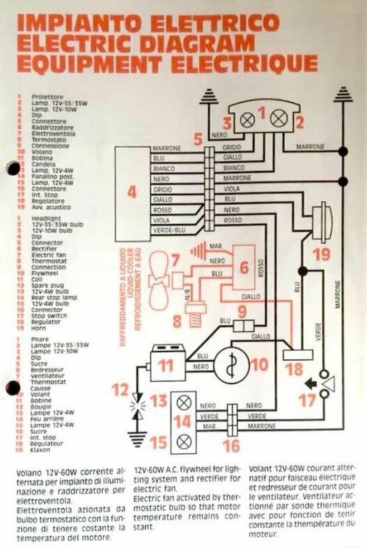

Google up: "gasgas motoplat wiring diagram"
Yellow wire powers your 12VDC accessories and has a resistance value of 1K ohms, the black 45 ohms and blue 35 ohms.  Ignition coil should read 1.5 ohms
Rectifier and regulator are for the 12 VDC accessories including the fan.
I remembered this when relooking at your forum post. The original Motoplat ignition has part of the CDI unit in the Stator and the rest of the CDI unit in the HT coil. PVL makes a replacement HT coil that should work if the stator is still good. I believe that Rex's Speed Shop sells this replacement PVL replacement HT coil.

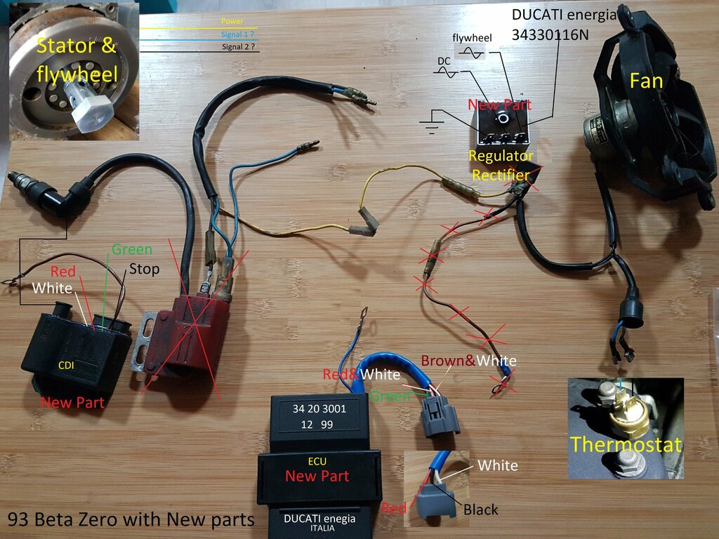

Hi Everyone
Yeah naah naah, after some more poking around still no fire in the wire. The GasGas Diagram was helpful but still no flash.
I think I'm just gonna try to get a full replacement system, Any suggestions on where to shop? Lots of aftermarket systems on the interweb but I didn't find Beta stuff.
