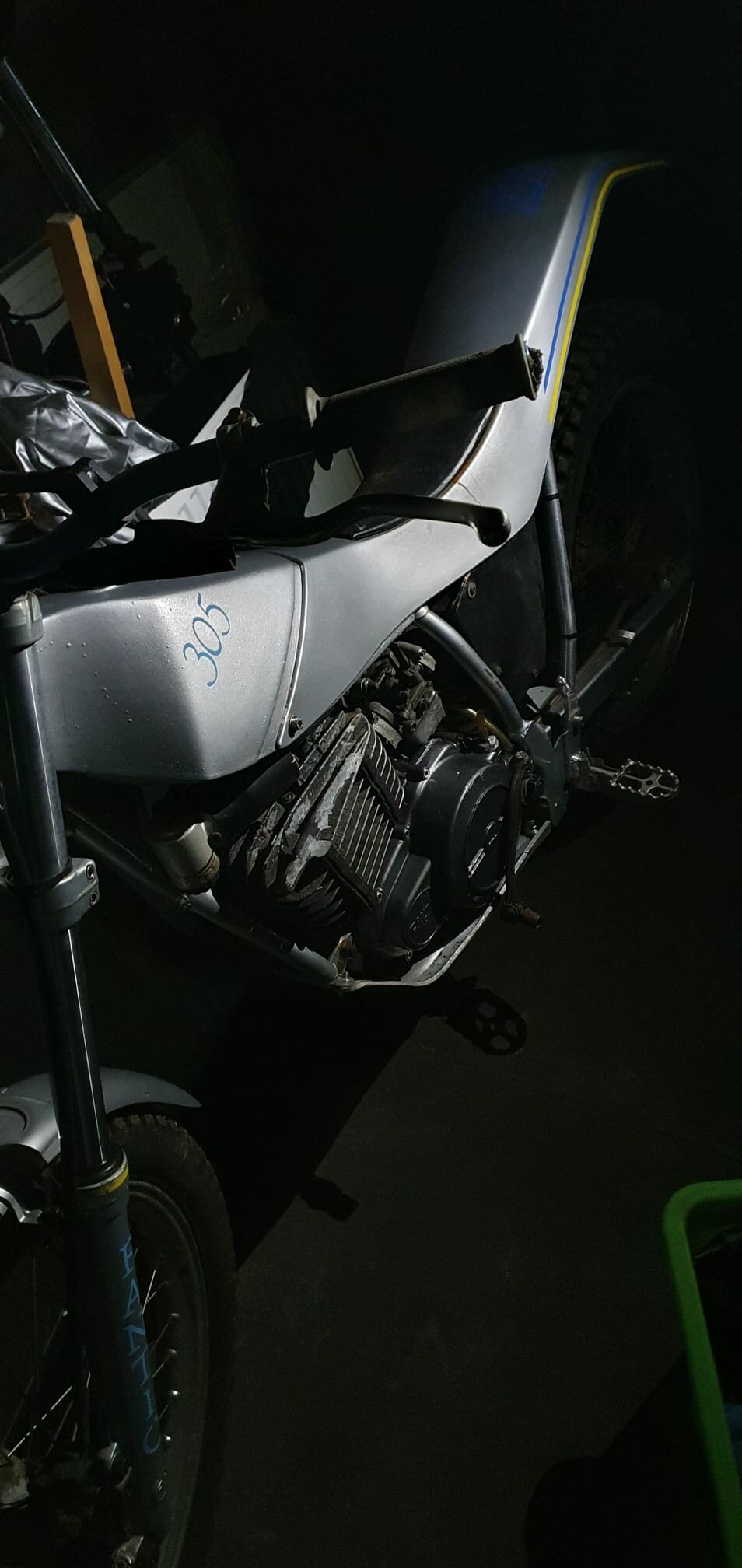

  3. Hi guys n girls I’m looking for a top intake pipe for my fabric 305 air box as it’s missing on my bike and I keep drawing in water and mud/crap into the carb which in turn is affecting the carburettor pretty bad every two three rides I’m having to clean the carb but Iv seen from pictures my bike should have a little pipe on the top of the air box can anyone help does anyone have one or can anyone tell me where I might get one thanks folks Bryan
