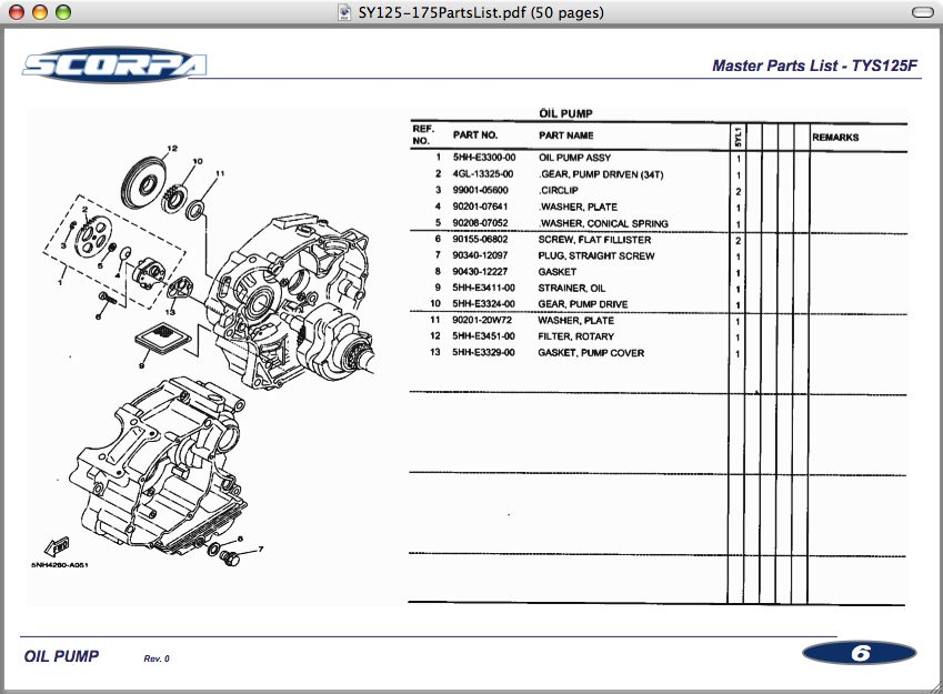

piruleiro Posted September 21, 2006 Report Share Posted September 21, 2006 hello, where is the oil filter on the scorpa 125 4T engine? how should I clean it? also, I've got some problems setting the magura hyd. clutch. it slips a little bit, especially when the engine is warm, so I tried to tweak that red setting screw, but it does not change anything.... any helps? Thanks Quote Link to comment Share on other sites More sharing options...
Guest DGShannon Posted September 21, 2006 Report Share Posted September 21, 2006 The red screw adjusts the lever position closer or further from the bar. Look on the opposite end, where the slave cyclinder mounts to the engine. If you look close, the little rod coming out of the slave is slotted for a screwdriver. You can screw it in, or out, as necessary to adjust the position of the actuator arm. Quote Link to comment Share on other sites More sharing options...
arnoux Posted September 21, 2006 Report Share Posted September 21, 2006 (edited) There is an permanent oil strainer inside the crankcase. User's manuals for this engine are available at Yamaha America online Here Edited September 21, 2006 by arnoux Quote Link to comment Share on other sites More sharing options...
