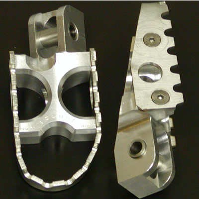

OBTW, are these what you call j-pegs?

Those are it. You can get them with 3 different offsets depending on what you like best.
The outer band is not as strong as the Hebo but thats not a bad thing. If you smack them hard that outer band soaks up the hit leaving the important parts unhurt. You can take the band off and smack it back into shap or just put on a new one. Smacking a one piece footpeg back into perfect shape is not a very easy task.
I like the larger bearing surface and the fact they come with a 1\2 inch backwards offset.
