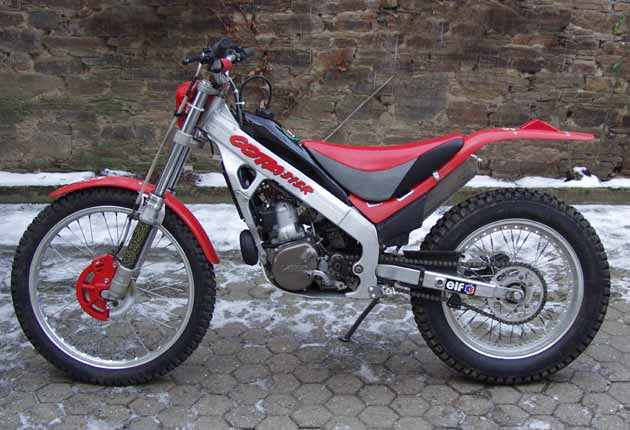

anyone got a picture of a 315 with the tank and seat combo you can get for long distance riding. I've been looking around for one but haven't come up withanything yet. Where can you order them from. i didn't seee anything on the montesa site.

A PIC!!!
Thanks dude! That doesn't look too bad!!
Looks like it would open up another avenue of use for the bike.

You asked for a picture:
I tell ya, this 4rt set-up with seat is the best I've seen ............good when you need to take a rest ................................do these people sell this seat combo???

Here is an original picture of the Montesa Trialmaster:

You can go about 45 - 50 mpH. I dont know the seat height exactly but it just a little lower than the rear fender. If you sit down, the bike lowers again ca. 2 inches.

A few more pictures:

Nice pics! Is that a speedo mount to the bottom fork tube?? Guessing that has something to do with getting it plated??
