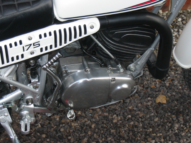

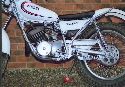

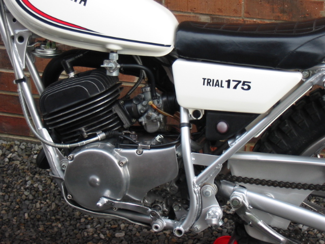

There is a Haynes manual available for the TY175. Will have to check my bike out, but I recall the hubs, or at least the brake plates have magnesium stamped on them. I'll snap some pics of the bike including the exhaust system. Will take a couple of days though, work is getting in the way of fun this weekend.
Final one for now............
These pics are taken from my TY175, which is completely stock standard entirely and is good as the day when it was new.............having never been used off-road, so you can see what a standard TY should look like.
Unfortunately most have been used and abused by now.
I also have brochure pics, if you need these to help and also specs from Haynes and Genuine Yamaha Owner's Manual should you need this.
