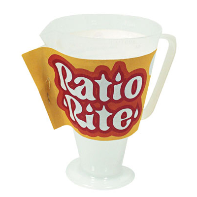

Try This
So 62.5ml in a 5 litre can ............ KSV Well done :D
