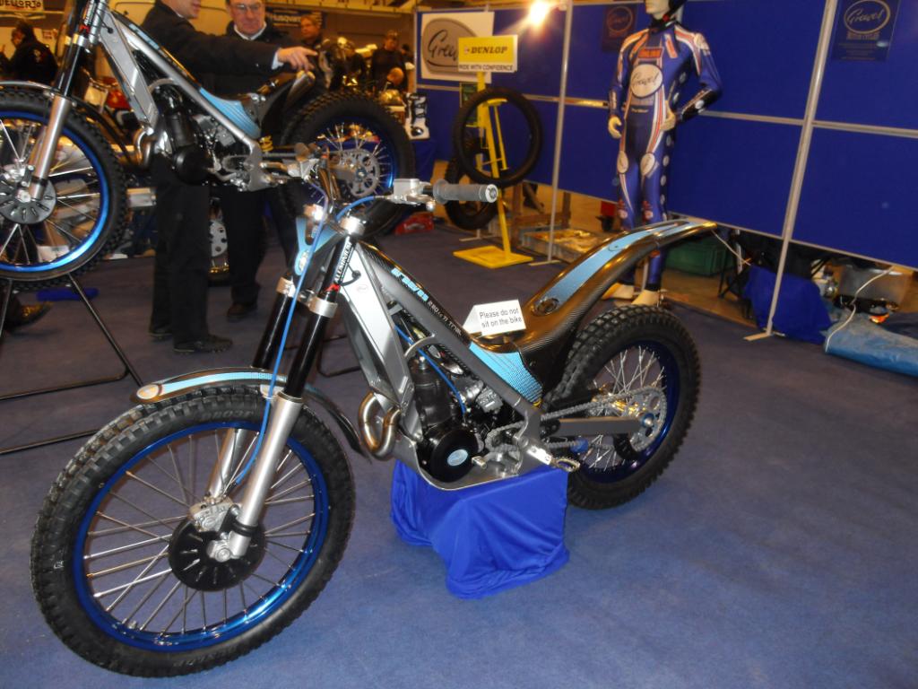

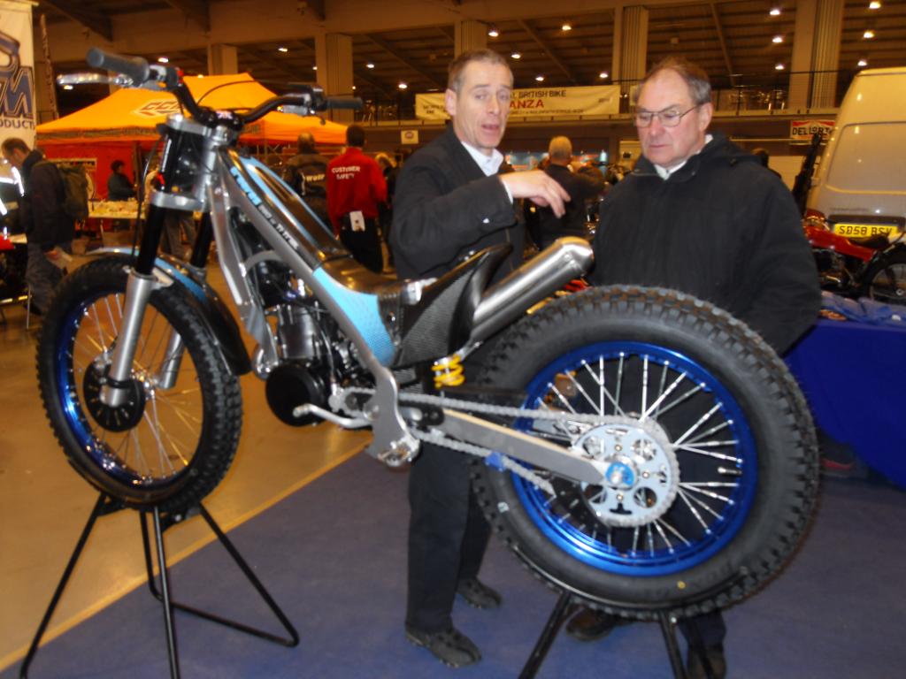

Pictures courtesy of KD Hewson

Well it certainly looks a lot better than the first prototype.
Still looks a bit bulky around the seat / airbox area.
Also, the front pipe seems to sit quite low, looks like it could be a bit vulnerable.
Why a year to make some improvements and why has no one seen it running/tested in a trial?
looks better but still very pre-10 shercoish. think the swinging arm hollow underneath is suspect.
I noticed the carbon fuel tank extends right down level with the bottom of the shock
and the fuel pump is mounted on the bottom of the tank -
but also the big banjo and hose on the underside of the pump is level with the sump plate
without any protection at all!
First rock that you would slide over would wipe out the fuel pump!! - good design!!
It did have an Ohlin shock and titanium front pipe though!

Now if they had shown that last year they would have gotten far more positive feedback! although now though, like Dabster says, it looks so dated like an old Sherco, but with a bit of bling maybe.
The new stuff doesn't interest me either but how is it the new generation and improved on last years product I have never seen one, were any tried or tested or will we be looking at Mk 3 next year still no wiser ?? Or have I missed something.??
