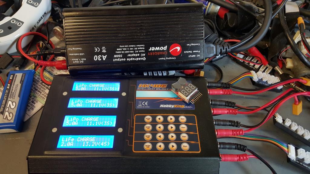

I have a decent charger and PSU for my multi-rotor but most I can charge at is 5A and wondering what sort of time will it take to charge 20Ah battery (4 of them). I've been pretty decent about my Lipo batteries except maybe for storing them charged for too long.
I was planning on making 4 super long balance charge extensions and balance charging every time.
