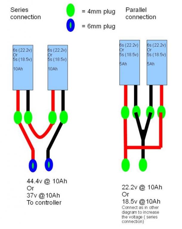

your above diagram looks good on the charging side but looks more complicated than it needs to be for the running side..
let me see if i go a diagram somewhere that i can post up..
Edit:
here you go..

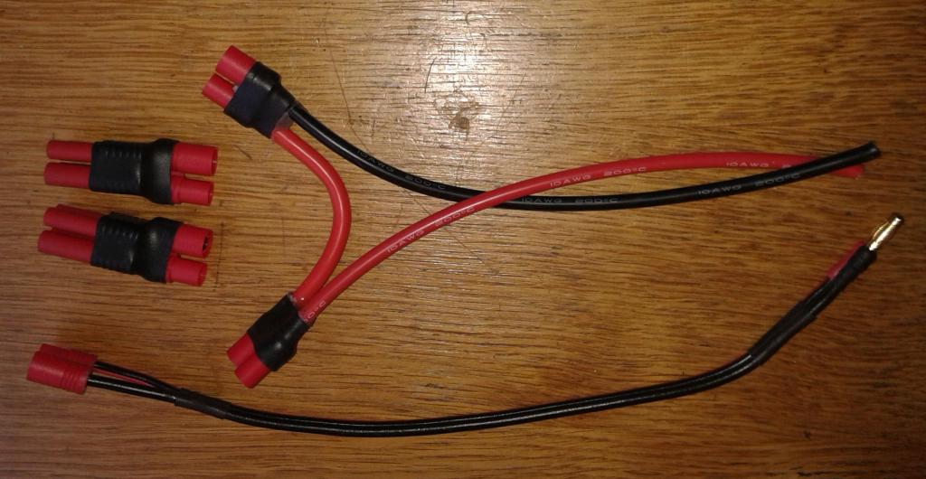

treat each P block of 5s (in your case ) as a complete battery that can be permently wired together, yes it can be soldered ,, this includes the balance taps...
then you just need the one Y connector/adaptor to connect to the bike..
some thing like this.
this is a complete set of charge/discharge adaptors for lipo that are pre fitted with 4mm bullet connectors that allow easy connect/disconnect to the bike ( just 2 plugs )
its the Y bit that is the key to it :-)
you will also have to buy some P balance adaptors... some thing like this

your running wiring still looks more confusing than it needs to be..
the charger in your link is a 300w charger so it will charge at a max of 300W
a fully charged 10s  lipo is 42.00v  so this is how you can work out the max charge current for the amount of cells being charged.
W= V x I  so if you transpose that to  W / V = I
i.e 300W / 42v = 7.1A  ( or there abouts )
so the charger can put 7A into your battery every hour ( 7ah )
So if you had a 7ah battery then its about a hour charge and a 14ah battery it will be 2 hour charge.. but this is into a totally flat battery ( which is never advisable to run down a battery especially a lipo beyond a 80% discharge for max cycle life span) so I take around 20mins off the fully charge times
