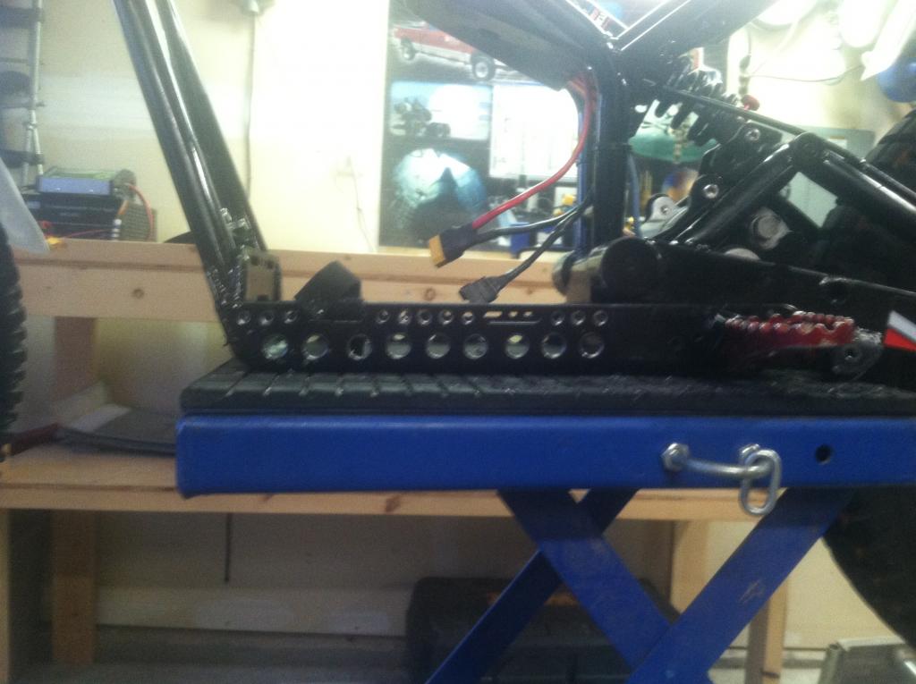

It's hard to bevel that it has been 4 years since I started this thread. Thanks a ton to Gwhy for answering all the questions and taking care of everyone. I feel like I should contribute something so here is an update on the batteries I use these days.
I played around a bit to find that the high voltage cutoff on the 20" is 60V (at least for 2014 and earlier controllers for sure). To take advantage of this I changed to a 14s1P setup for competitions. I get there by using the 8 aH Zippys with two 6 cell and one 2 cell in series. This lands at 59.5V hot off the charger. This lets us get through most of our local trials (Novice class) on one set. We do sometimes use two sets for our longer events. My daughter is 12 now so she monitors the aHs used and changes the batteries herself.
I rig up all of my bikes with the bigger XT-90 connector but still use XT-60 on the batteries. This allows me to make different wiring harnesses for different setups. The normal harness does the 14s1p. I have one that does 14s2p for longer trail rides. I also have one that goes to spades for lead battery comparison testing and one that goes to rings for Earth-x's. I recognize that at peak output I am pulling more current than the XT-60 is rated for (when I run the 1P setup) but I have never had one even get hot since you never run over 60 amps for more than a second or so.
While running 2p would mean never changing the batteries during competition I feel like changing them is worth it to shave about 6 pounds off the bike. I did a little weight reduction on her bike and got it down to about 60 pounds. I ditched things Ike the kickstand (Osets are like Montesas in that laying them on the ground is fine), ditched the ridiculously heavy key switch, and did some drilling and cutting to remove some of the way over-designed steel around the battery box.
Mounting lipos has gotten simpler since the 2014 model introduced the inclusion panels. I put a piece of plastic in the battery tray to protect from poking objects through the holes in the skidplate. It turns out the black plastic pieces in the shipping box for the bike work great after some trimming. I then put the batteries in the tray parallel to the wheels. I used Velcro with sticky back and put four pieces permanently on the bikes through the slots in the sides of the tray. I then use two pieces of non-sticky backed velcro to connect across the top of the batteries. I had to add a notch to each exclusion panel to go around one of the pieces of velcro. I ended up ditching one of the factory pieces of velcro on on exclusion panel to make it faster to open and close it for battery swaps. I will try to get some pictures of that posted soon. I have not yet converted a 2015 but I suspect I will need to figure out a different velcro method. There is a 2015 20" Race sitting in the garage that may end up being my daughters new ride if I don't sell it out from under here again so I will let you know how that works out.
Pic of holes drilled for weight and stylish looks.
