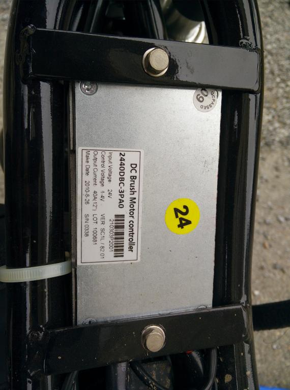

tried to to test my bike and added normal 12v battery in series so total voltage was 36v.Lights turned on but back wheel does not spin. Is there anything I can do that I get it working? I want to get it working before ordering lipos. I attached picture of my Oset 12.5 24v motor controller.
If you just replaced you're 24v with 36v then is will either work or it wont. Some controllers have a hvc built in so higher voltages can not be used , I think this may be more on the 24v controllers than the higher voltage ones. I think some people have used 36 on a 24 with success so I think there may be different controller models used on the range of the 24v bikes.
No I dont think it will be a option to remove the hvc as there will have to be a fair few other modifications that would have to be done to the controller .. ( the hvc will be there for a reason )  .. you could look for a after market 36v or 48v controller something like this http://kellycontroller.com/kds72100e100a24v-72v-mini-brushed-controller-p-761.html  or even sometihng like this may be ok to try if you want it in a hurry and cheap :-) http://www.ebay.co.uk/itm/36V-800W-Speed-Controller-Box-Electric-Bike-Scooter-Brushed-/251638297450?pt=LH_DefaultDomain_3&hash=item3a96cfb36a  ..   I have no idea on how this controller will perform but for the price it may be worth a punt.
