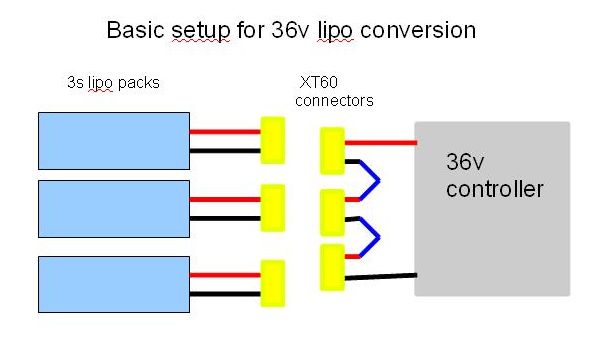

as you have 4S lipos and you want 48v then you will need to have this arrangement when connecting to the bike , it dont have to be exactly as in the picture but it should give you some idea.

See the parallel and series diagram that GWHY posted on the previous page for connecting your batteries to get the 12s. I'm not sue why you can't run them 12s2p to get 16000mAH (mine is 20000mAH) but GWHY is the guy who knows and can answer (I will overheat my motor before i hammer out my whole charge my pack).
For parallel charging, you can make two cables, one that will parallel them all to charge, and another that you use to run them in series to connect to the controller. Here is a good place to get very high quality ones custom made if you want to go that route (he also has youtube videos descrying his cables).
For my setup I balanced each battery first (important!!!) than just soldered the parallel sets together, and connected the series via solder so it's all one pack. I balance charge it each time and can still check each cell with the individual balance leads when i want. I connect it to the Oset with XT60 and replaced the stock connector with the same so you can just swap.

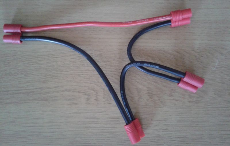

each battery has a number of cells in them and each cell =3.7v and the batteries you have bought have 4 cells each battery so each battery = 14.8v so you will have to series 3 batteries together to make up a 44.4v ( 48v) battery ( I would have recommended 6 cell batteries as its one less connection to worry about and it makes things a bit easier when it comes to charging) , you can do this as in the diagram that I posted on this page. As you are new to all this I would suggest that you only use 3 lipo's at a time , Don't worry about parallel for the moment as this will get a bit more complicated. The wiring on the bike will not have to be changed but you will need to make a connecting lead ... similar to this one but with a xt60 connector so it fits into your existing plug on your bike, the lead in this pic has 6mm bullet connectors and you will need 4mm connectors instead so that 3 of your batteries can plug into the lead. You will have to unplug each of the 3 batteries from the lead to charge them.
I dont know if Andy would approve of this shameless plug of what I do, but I do make and sale custom battery harnesses, and many other bits and pieces for electric bikes , so If you would like any help please drop me a PM.
Edited by gwhy
Just looking at the link for the batteries that you have bought it also looks like they have 5.5mm un-shrouded connectors ( be very careful not to cause a short! ) fitted as standard so you will need some 5.5mm bullet connectors to make your lead not 4mm as I suggested in the previous post. But to be honest I would fit shrouded plugs on the batteries for safety reasons.
