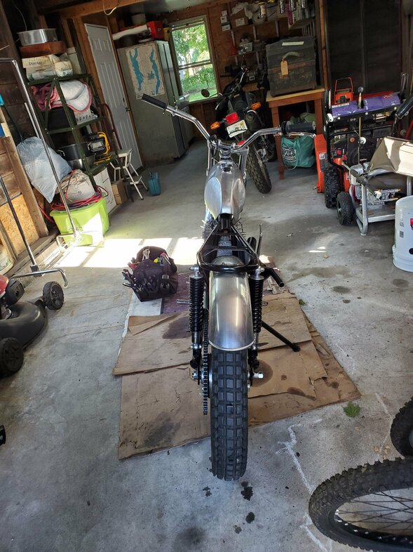

January 27, 201214 yr I have a Puch engined Dalsman Trials too that I have been working on. Here is a picture of the ad I bought it from. It's in pieces now slowly going back together. Here are a few more Dalesman pics you may enjoy.
January 27, 201214 yr Author I have a Puch engined Dalsman Trials too that I have been working on. Here is a picture of the ad I bought it from. It's in pieces now slowly going back together. Here are a few more Dalesman pics you may enjoy. Those are great pictures, thanks. It's always useful to see those little details as they should be, like the heat shields.Cheers.
