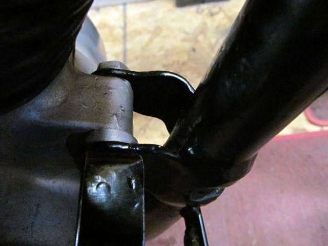

  • Going back to the original question. On my original Sammy Miller Cub the engine was offset to the left, primarily to give better chain clearance and tire clearance on the swinging arm. The SM swinging

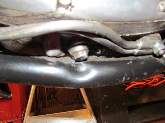

Going back to the original question. On my original Sammy Miller Cub the engine was offset to the left, primarily to give better chain clearance and tire clearance on the swinging arm. The SM swinging arm kit comes complete with the rear wheel sprocket spacer which obviously moves the sprocket further away from the line of the tire. Up front on the Miller frame the front engine mount is widened to allow a distance piece to be inserted to the left of the motor. 2 other distance pieces are used on the lower mount and also the rear. Front and rear sprockets have been displaced the same distance and therefore line up.
The lower tube has been subjected to some serious "SM" wellie!! to allow the oil pipe assembly and drain plug to be accessed Personally I thought this was VERY CRUDE. Also by moving the engine over the front of the exhaust pipe is very tight against the front downtube.
My current frame doesn't use any offsets, and the lower tube has had a tubonectomy which as OTF said gets rid of all the oil issues
