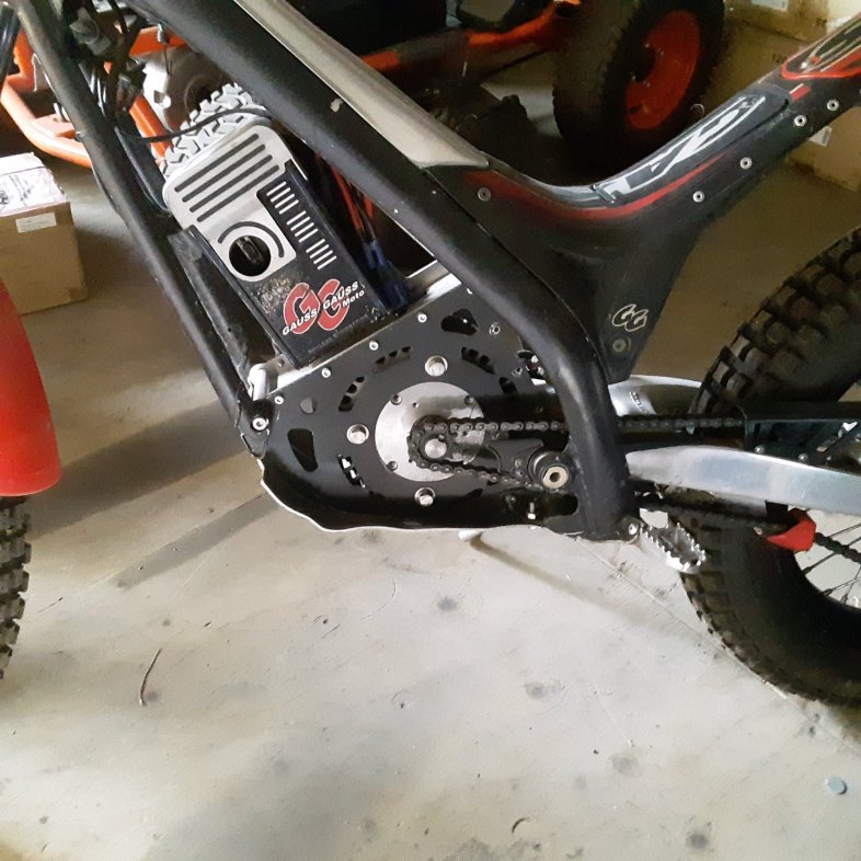

  • I bought a used Gas Gas TXT 200 and converted to electric. I used a Briggs and Stratton E tek motor direct drive (11 / 60) gearing with a 428 chain / sprocket that I made. I use a battery pack made fr

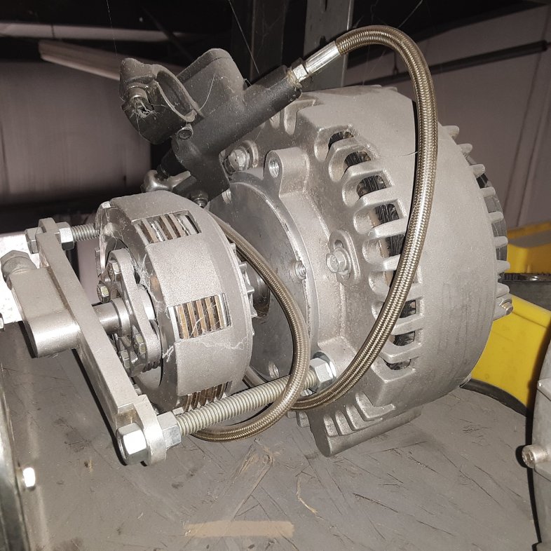

I guess I am sort of obsessed with the idea that at some point a pro rider will whine that electrics can't do the big launches. The design I'm working on is a sort of inside out version of a typical gas bike clutch. So instead of the primary gears being the input and the mainshaft (inner hub) being the output of the clutch, this design would use the motor shaft keyed, splined, whatever, to the inner clutch hub. Then the output would be a countershaft sprocket attached to the outer basket. The crank assy (w/ flywheel) on most gas trials bikes is around 20 lbs, the same weight approximately as the rotor on most electric motors of this scale. I think with the added inertial moment of the pancake motors relatively large OD, you could get more flywheel driven launch than a gas bike. In fact, I think that maybe the electric motor could be even lighter, maybe just 10 to 15 pounds of motor total weight with more inertia from added RPMs if needed. Anyways, this is just kind of a dream of mine, that I could make an electric that out-performs a gas trials bike and still weighs less. I think the technology is here today to do this.

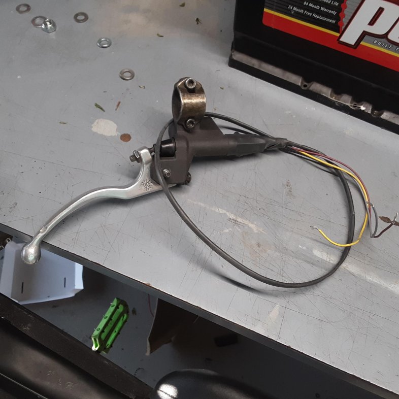

So last night I rigged up a clutch pot, using a 5k linear pot with a 12mm stroke, the same as the master cyl piston travel. I think if I put the pot in series with the throttle pot (2-wire), with the low resistance position in the 'clutch out', it would work as normal. But when I pull the clutch in, it will effectively reduce the throttle signal. Due to my dyslexia, I probably have this backwards, so I'll be sure to remove the drive chain while futzing around. It should work similar to your more elaborate scheme, which I cannot do with this controller.
