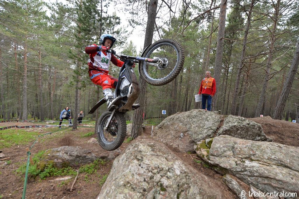

EM have a presence at the World Championship riding the 125/International route. There were a couple in Andorra last weekend and another two here in Lourdes this weekend. If/when it gets to three riders then there will be a podium specifically for electric bikes.
They can't half nip on, but are a bugger to photograph because you can't hear them rev to prep yourself like you can with trad bikes.
