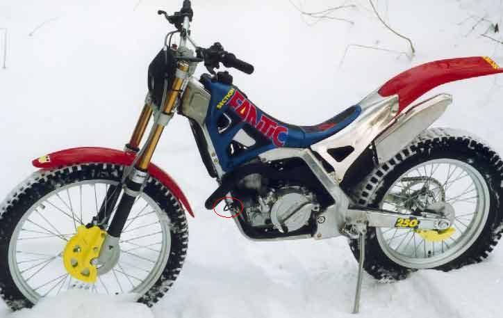

ronoc88 Posted May 29, 2005 Report Share Posted May 29, 2005 (edited) This is a really not good picture of a cable that goes from, around the water pump, up to just above the exaust manafold on my fantic. This cable controls 2 small valves. Thats what i know. Now can any of you experts tell me what this cable does?? Edited May 29, 2005 by ronoc88 Quote Link to comment Share on other sites More sharing options...

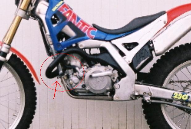

ronoc88 Posted May 29, 2005 Author Report Share Posted May 29, 2005 Another picture. Quote Link to comment Share on other sites More sharing options...

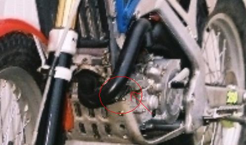

ronoc88 Posted May 29, 2005 Author Report Share Posted May 29, 2005 Yet another picture. This cable has broken. So can anyone also tell me of somewhere that stocks fantic parts?? Has anyone ever come across a spare parts list for a fantic?? gratefull for any help on this one really am baffled. O and just a note the bike seems to be running fine without this cable. Quote Link to comment Share on other sites More sharing options...

lineaway Posted May 30, 2005 Report Share Posted May 30, 2005 Fantic is the only trials that used a power valve. That is what the cable did is raise the exhaust ports with rpm increase. Quote Link to comment Share on other sites More sharing options...

ronoc88 Posted May 30, 2005 Author Report Share Posted May 30, 2005 (edited) Cheers for the help lads. Lineaway thanks for the info. Just wondering what effect would this operation have on bike performance. I dont belive that this part has been working for quite a while as it was broken when i took it off. Does anybody know anything about this part. Will it improve the bike performance if re-assembled? Thanks in advance Edited May 31, 2005 by ronoc88 Quote Link to comment Share on other sites More sharing options...
