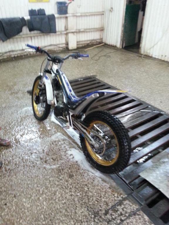

I assebled the bike and started it simply. Firstly, i washed it by hi pressure and some water has poured in to the stator through the cables. The spark was disappeared. Two weeks the bike was tested in order to find out where the problem was.
