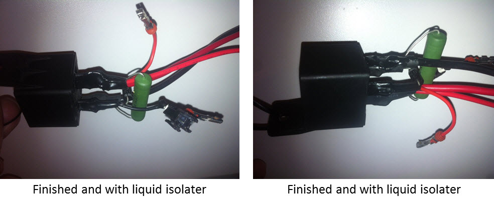

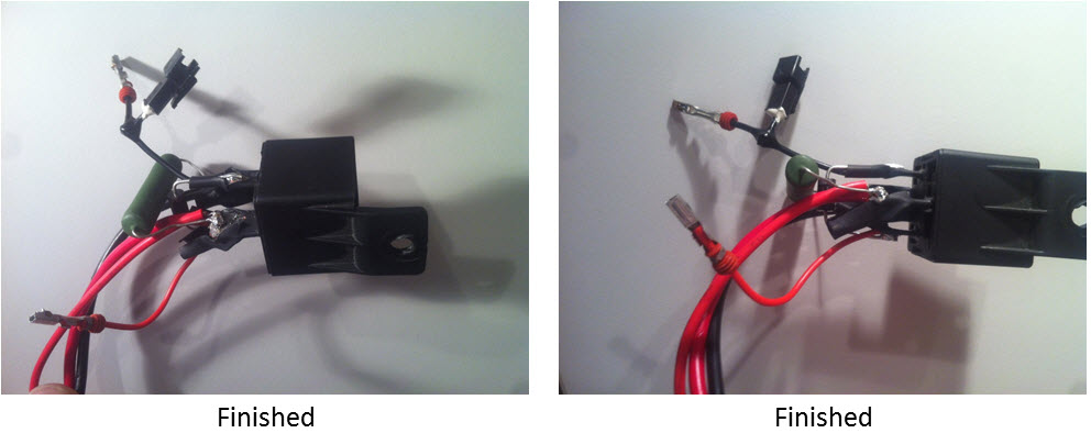

redondo76 Posted September 23, 2013 Report Share Posted September 23, 2013 Hello Rich, Thanks! Now I can finish off the wiring. Yes, I have soldered the resistor between top and bottom. (The pic I posted was before I soldered it on). Attached is a picture of the completed relay with diode and resistor. The loop-wire will come off. I will completely remove the old shrink tubes and put PlastiDip (liquid isolator) on to make it look nice and tidy. I have taken some pics, so once I'm finished I'll post them all. I have upgraded the bike with hydraulic brakes and now with LiPos and Kelly Controller. I think it's going to be a good improvement. Eirik Link to comment Share on other sites More sharing options...
mxoset Posted September 23, 2013 Author Report Share Posted September 23, 2013 Eirik, I think the diode between left and right terminals is the wrong way round. This is my fault as the diagram and pictures are the opposite way round. It looks like you plan to use that terminal with your black lead to connect to the Kelly green (4) lead? I called that terminal LEFT on the diagram. If that is the case then the grey cap of the diode needs to be towards the other terminal RIGHT which will go to the red (9) and 5A fused top connection. Rich Link to comment Share on other sites More sharing options...
redondo76 Posted September 25, 2013 Report Share Posted September 25, 2013 Rich, Thanks for your reply. It was when I saw the differences between your pictures and the wire diagram I started having doubts. But the explanation you gave earlier with the terminal and the key switch sorted it out. I have decided to follow the wire diagram. So I have now soldered a connector for the key switch on the cable going from terminal (left) to Kelly red (9). And I disconnected the loop wire and this now goes from terminal (right) to Kelly green (4) The diode grey band will then be facing towards terminal left where cable goes to Kelly red (9). Have started to put liquid isolator (plastidip.com) on the terminal connections and will shrink a large transparent shrink tube covering the whole terminal/resistor/diode. Eirik Link to comment Share on other sites More sharing options...

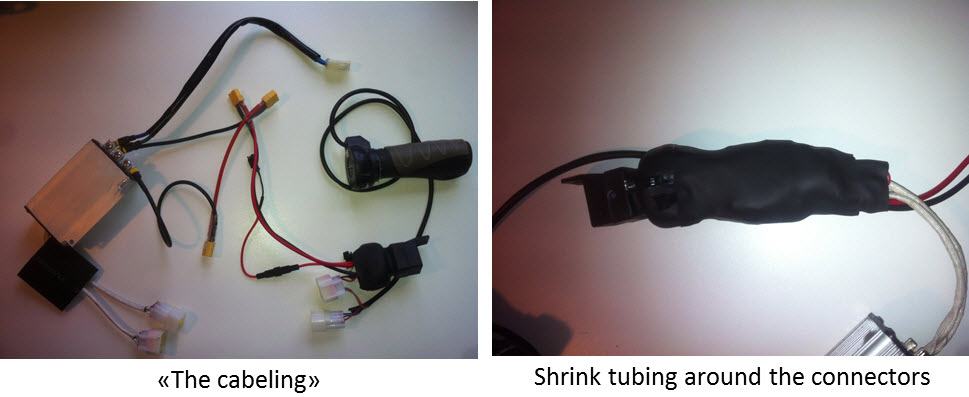

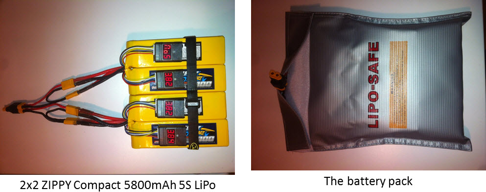

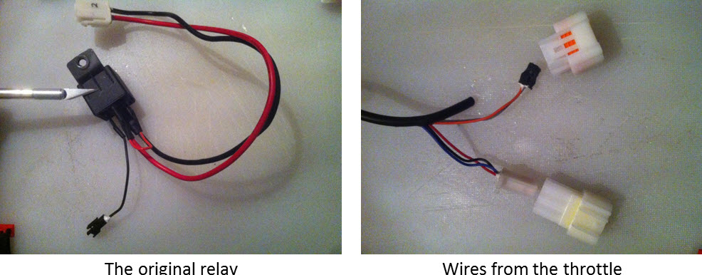

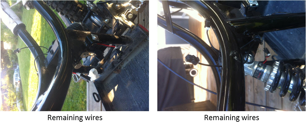

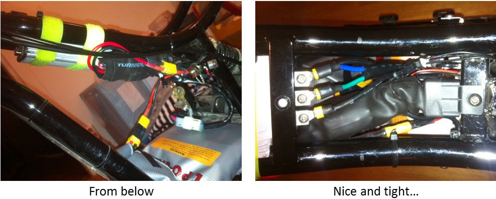

redondo76 Posted October 9, 2013 Report Share Posted October 9, 2013 Hello, Finished the upgrade to Kelly Controller and LiPo couple of weeks ago- and what an upgrade it is!! Better than I imagined and in my opinion how it should have been from the factory. I read some posts saying "it's all about learning throttle controll", but I don't believe so. The original controller setup is just too sensitive. Anyway, the KDS gives you so many possibilities to customize the bike to your preferences. My battery pack gives me about 42V when fully charged and 11600mAh. A lot more power than the original!! Avoiding wheelies is the "problem" now... Thanks Rich for all the help!! Here are some pictures from my upgrade. I believe they could be helpfull together with Rich's description. PS! I have bought 2 Right Angle RS232 Male to Female Adapter so that I'm able to connect the KDS with the laptop without having to unstrap the KDS. The way I have mounted the KDS "inside" the frame didn't allow me to connect the RS232 connector without loosening the velcros because of the tight fit. I'll post a picture soon... Cheers Eirik kelly OSET wiring diagram r harris 160813.pdf 1 Link to comment Share on other sites More sharing options...
