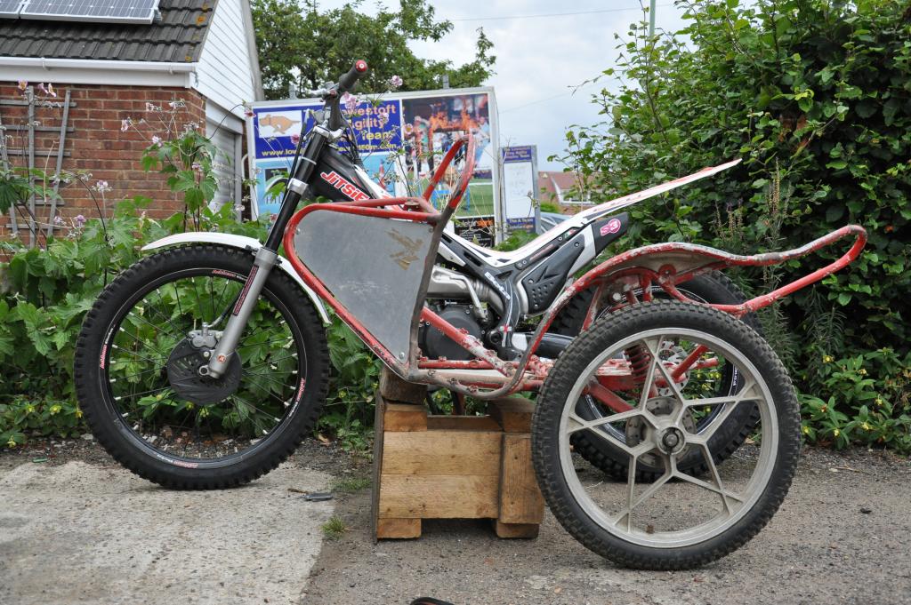

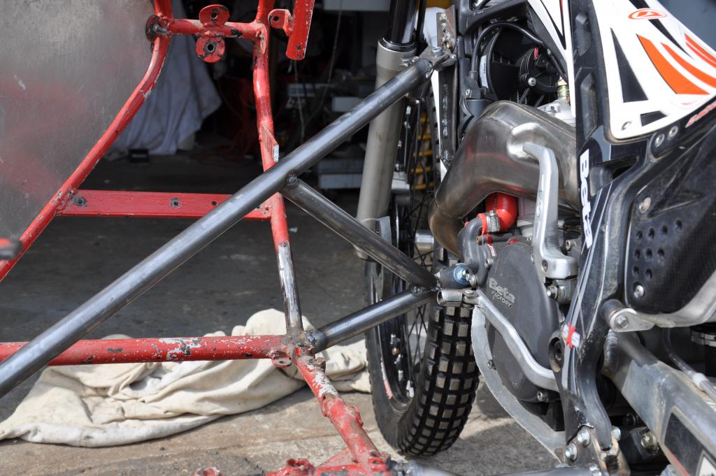

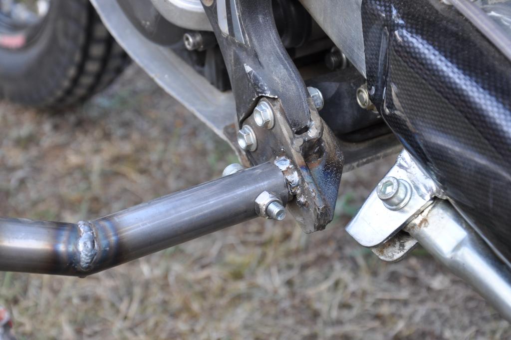

August 14, 201313 yr I made a start on my next sidecar project today. Been making the brackets and re-enforcing the front frame legs of a Beta Evo. Every thing so far is made from 3 mm flat bar. ether 30 mm or 50 mm wide. I will also be replacing the left hand foot peg hanger with one I am fabricating out of 5 mm x 50 mm flat bar. I will keep you all up to date with how things go. Edited August 14, 201313 yr by p@ul250

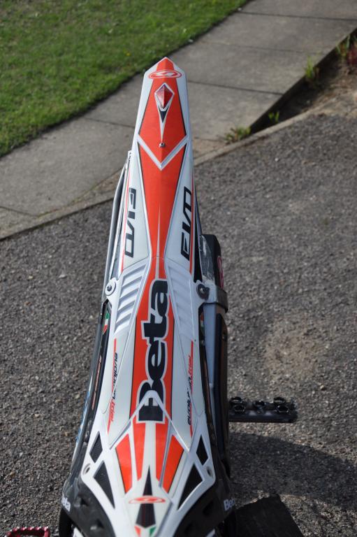

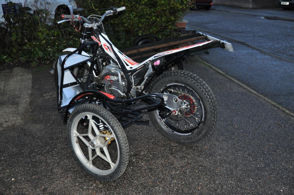

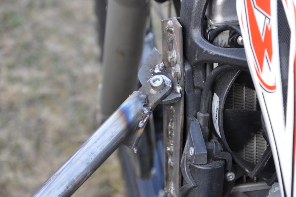

August 19, 201313 yr Author I had a bit more time in the workshop today and managed to get the chair attached to the bike. Every thing is tack welded at this stage. I had a run round the garden and up and down the street. All seemed OK. In the second photo you can see the replacement foot peg hanger I made from 5 mm steel and the front two mounts.

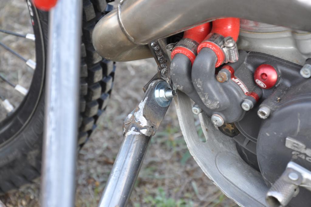

August 21, 201313 yr Author I Got a bit more done on the outfit today and yes I will remove the side stand when it's finnished

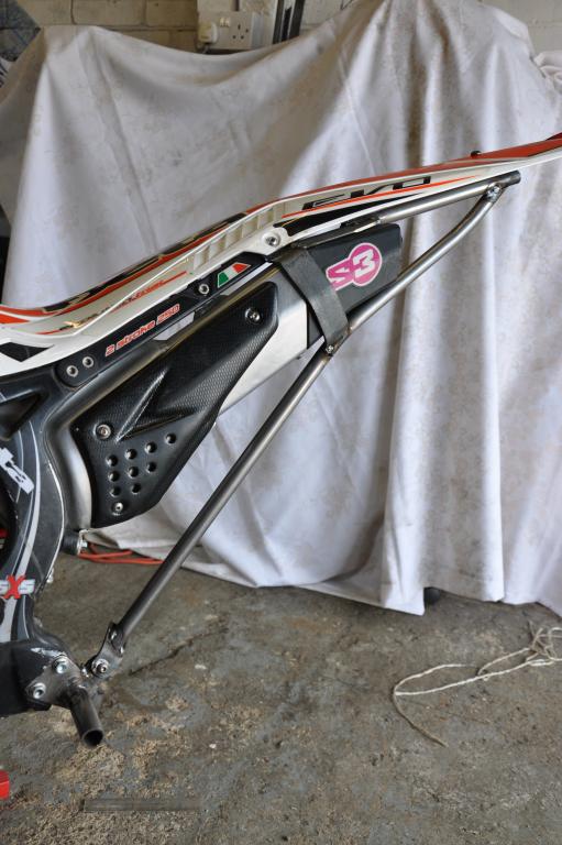

August 23, 201313 yr Author I made a start on the rear sub-frame. On these modern bike's you need something for the passenger to put there weight on, that won't just bend and brake.

September 27, 201313 yr Author Managed another two days on the sidecar project. Rebuilt the back of the Beta with all new bearings and seals and finished the rear sub-frame. Sub-frame offset to the right so that the passenger can have a hand hold and not trap their fingers in the wheel.

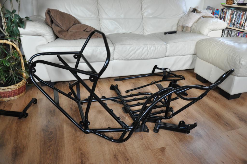

October 19, 201313 yr Author I've now got the sidecar back from powder coating. Hope to have her built up and running by the end of the day!

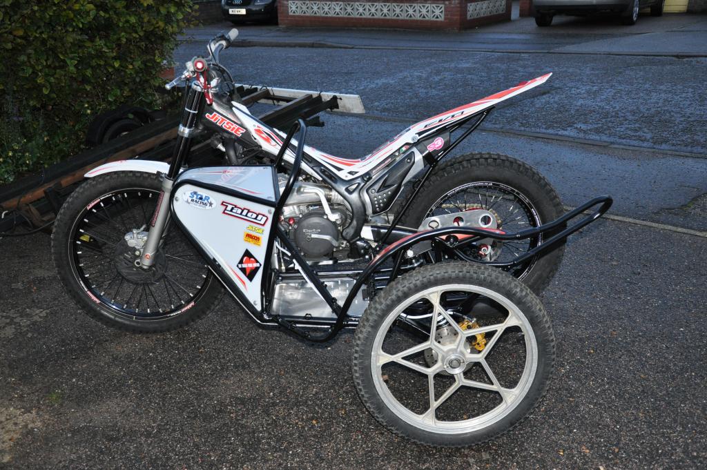

October 21, 201313 yr Author We had our first run out on the new outfit yesterday and Boy! was it fun. So much easier to ride than the Bultaco. More power, better steering (it go's where you point it) and about half the weight. all in all well worth the work!
