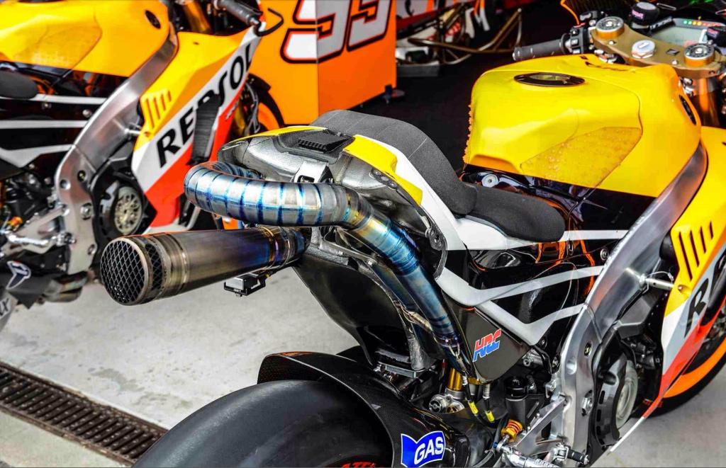

why is my s3 front pipe soo blue and purple compared to others which are silver/gold ?? does look awesome i think :) why does titanium do this?
Heat makes titanium go blue, maybe your bike is running a bit weak, so hotter than normal.
Wow that's a bike :0 I asked my friend and he said some people heat them with a blow torch to clean them out of oil and carbon deposits. ... This makes them go blue or it's been ridden hard on the road! Im not worrried about it just wondered why ti goes like that ! I love the look of it better than standerd

Dude, and Dudes? if the bike is like mine, it shouldnt be BLUE! My pipes weren't blue when new, but if yours started life like mine, and then it blues, It is an indication that you have let it get Way lean or way HOT.
But if the weld was blue when they got done making it, I guess you could be OK? Wierd from my experience (posted at bottom) my pipe on older bike turned blue, but from bolts to around that first curve. yours is MID curve, so I cant swear I am right. Big thing is, did it change?
I just dont believe a smart exhaust company would make the pipe and leave blue on it, since it is a sign of a problem, seeing it change to blue, can save you.

It's got nothing to do with to lean jetting, I just did a 4-day trial with lots of road between the sections and the titanium pipe on my 4rt, that was already a bit blue, got a lot more color to it.
This was only because I rode longer and faster than normal, so the engine got a bit hotter.
They use titanium because they can make the walls of the pipes thinner to save weight.
Thinner pipes overheat easyer and as a result get blue when you ride your bike a bit hard, that's all.
Or do you think the "jetting" on my fuel-injection suddenly got leaner!? I don't think so.
I know you only try to be on the safe side, but when the only thing you have changed on your bike is the front exhaust pipe, there is no reason to panic.
This is a brand new titanium pipe (the blue is from heating the pipe to bend it):

I've just checked and it is running abit lean (whiteish) colour of the plug. So done a half turn on the mixture screw out(richer ) I've just found out that some people down here heat the pipe up with a blow torch to clean the oil out and this makes them blue . Or it's been thrashed on the road...
I did a little experiment. Started the bike up and road around for a minute untill the fan kicked in. The bike was not hot at all really just normal. The pipe was a slight purple/ blue but still looked pretty original tbh.
Then I ragged it down the fields in 6th and it got really hot and dark ble like in the pic. (when I took the pic it was hot)
After the bike cooled a little it lightend up abit and was less blue...

To the OP... I should have brought pictures, but my 2010-2012 the welds have a blueish tint (they look like stripes) but the material between welds, are golden. yours looked to have gotten hot to me, and all the non welded materials turned blue, which is not good if it didn't get installed new that color. dad's 2013 we just un-crated has no blue at all when I looked although I didn't look that close (forgot about this thread)... makes you go hmm...
