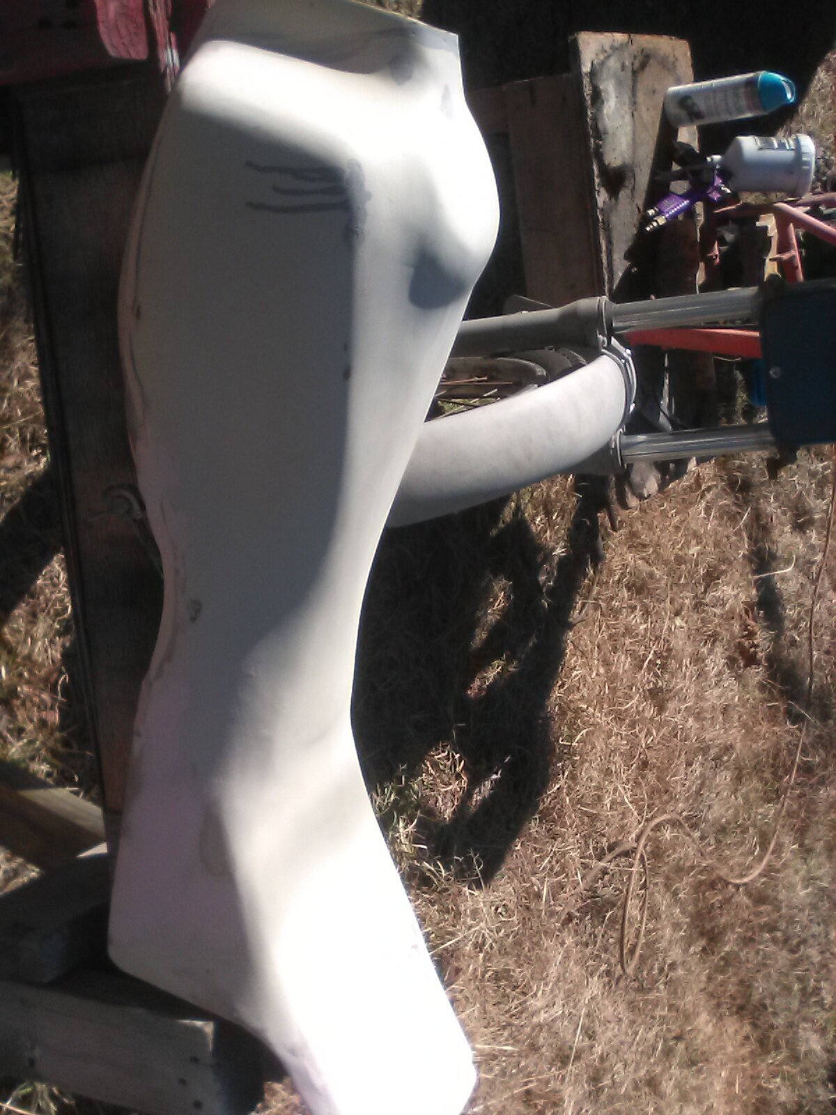

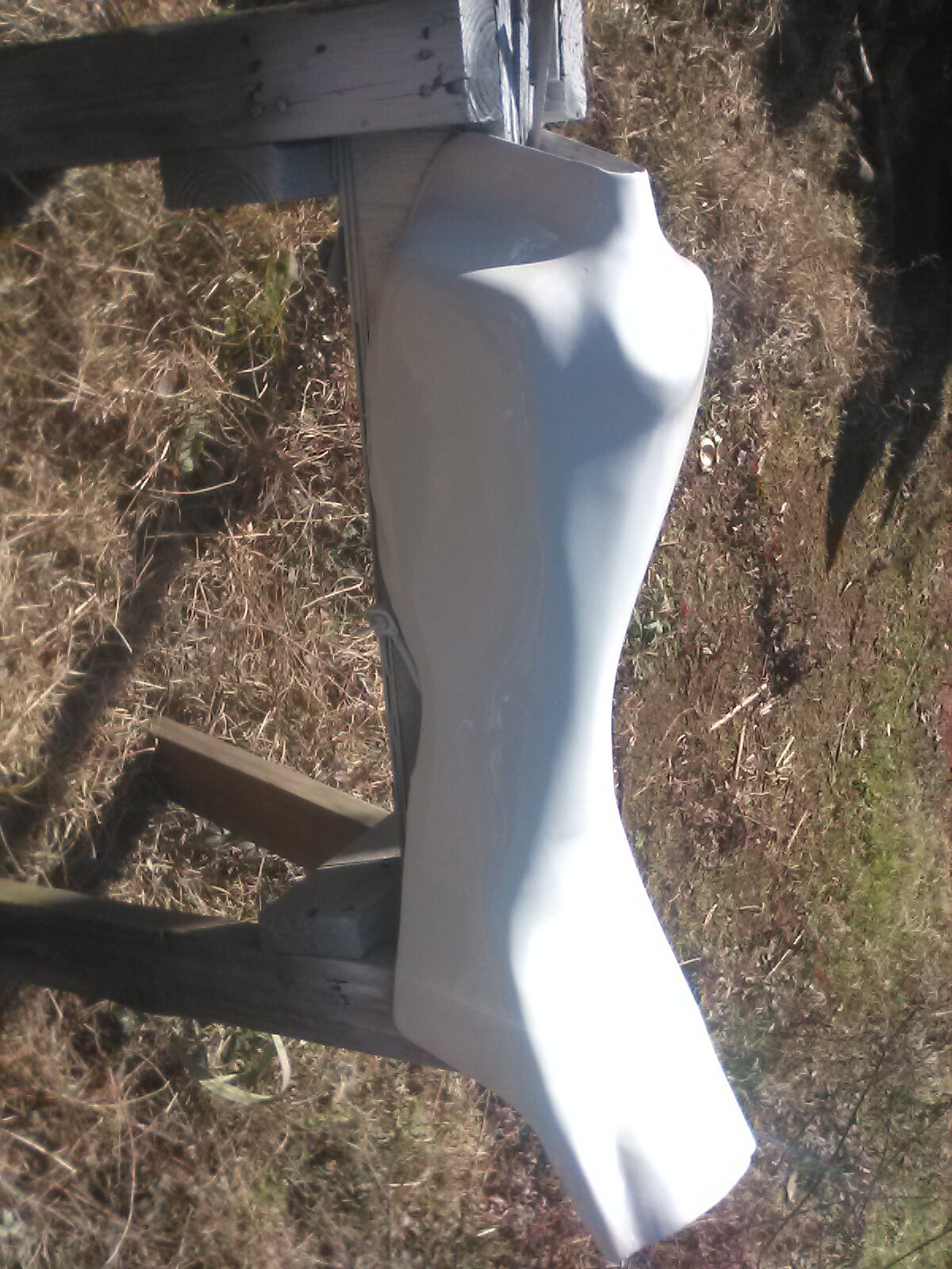

I believe I pretty much nailed it second time around, I have to build up the glass in some areas but the fit is perfect.

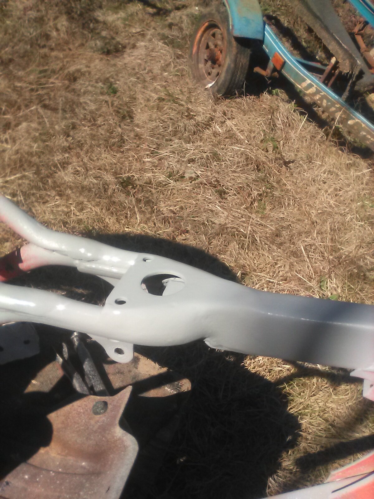

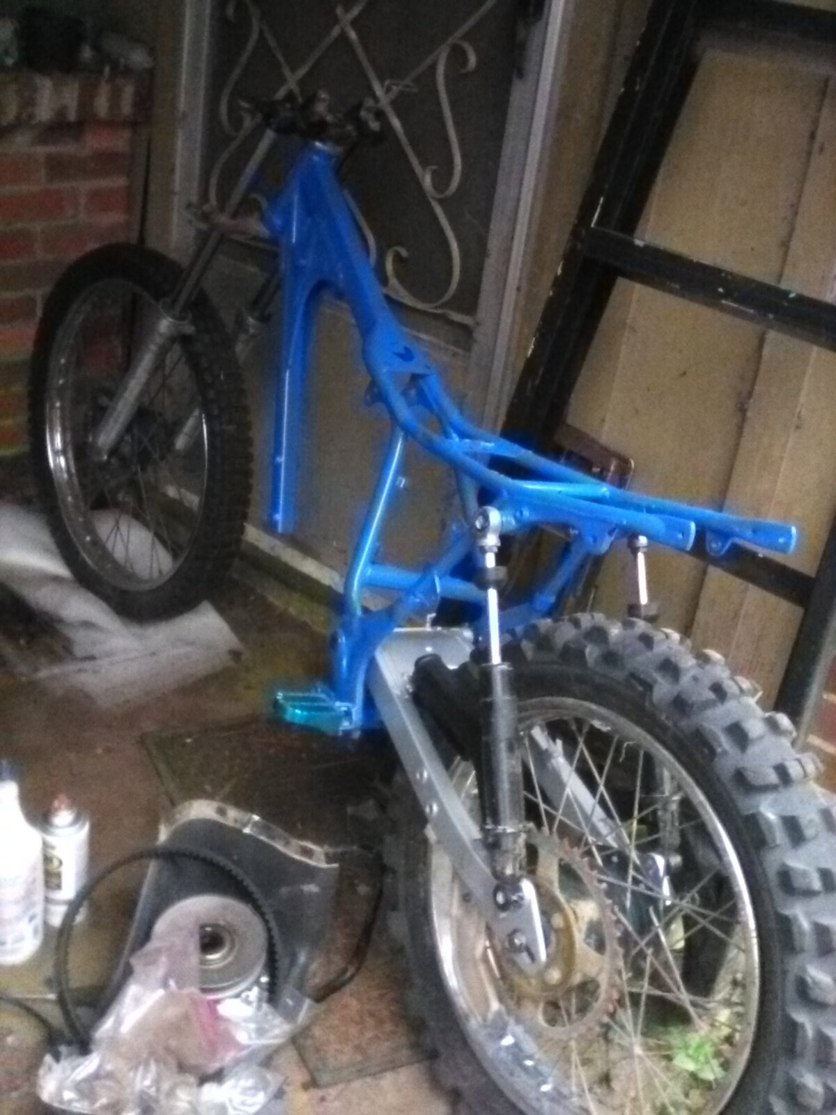

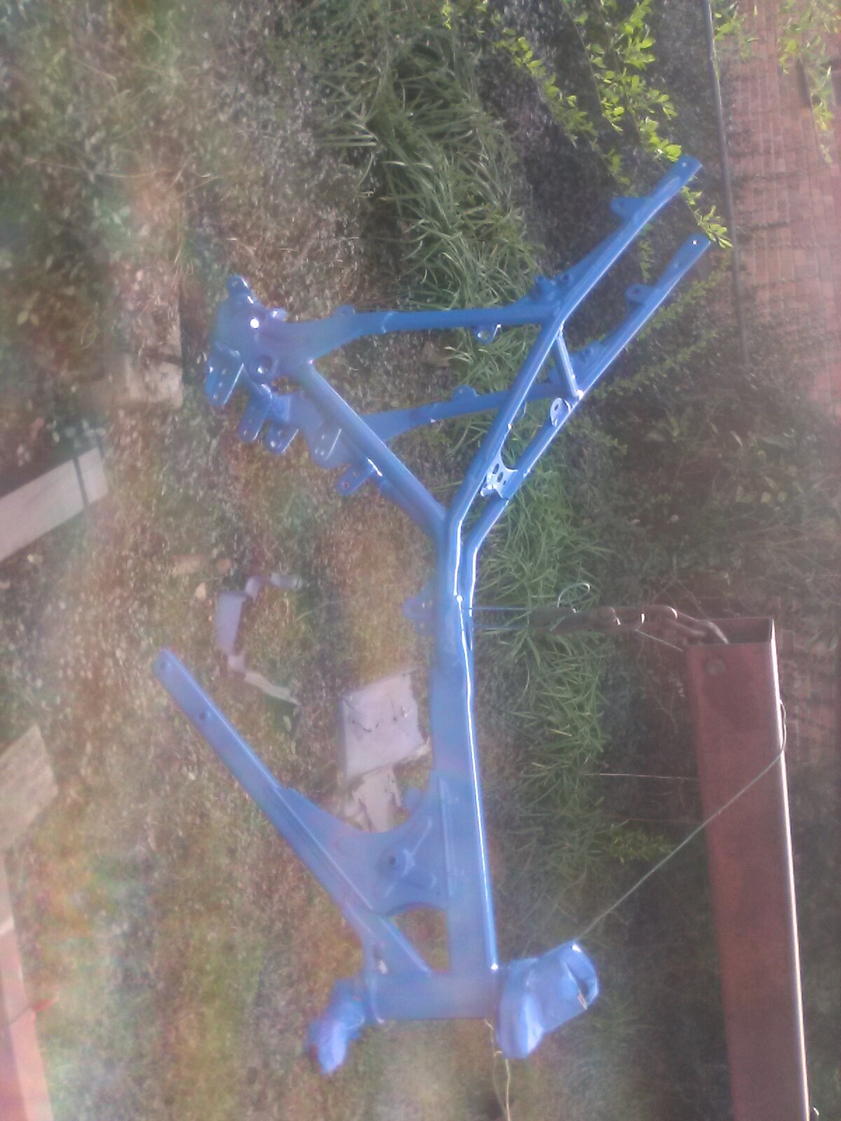

I realize this has been a dead thread for quite sometime but after several adventures I am back on it ., frame has been painted and we are rolling again

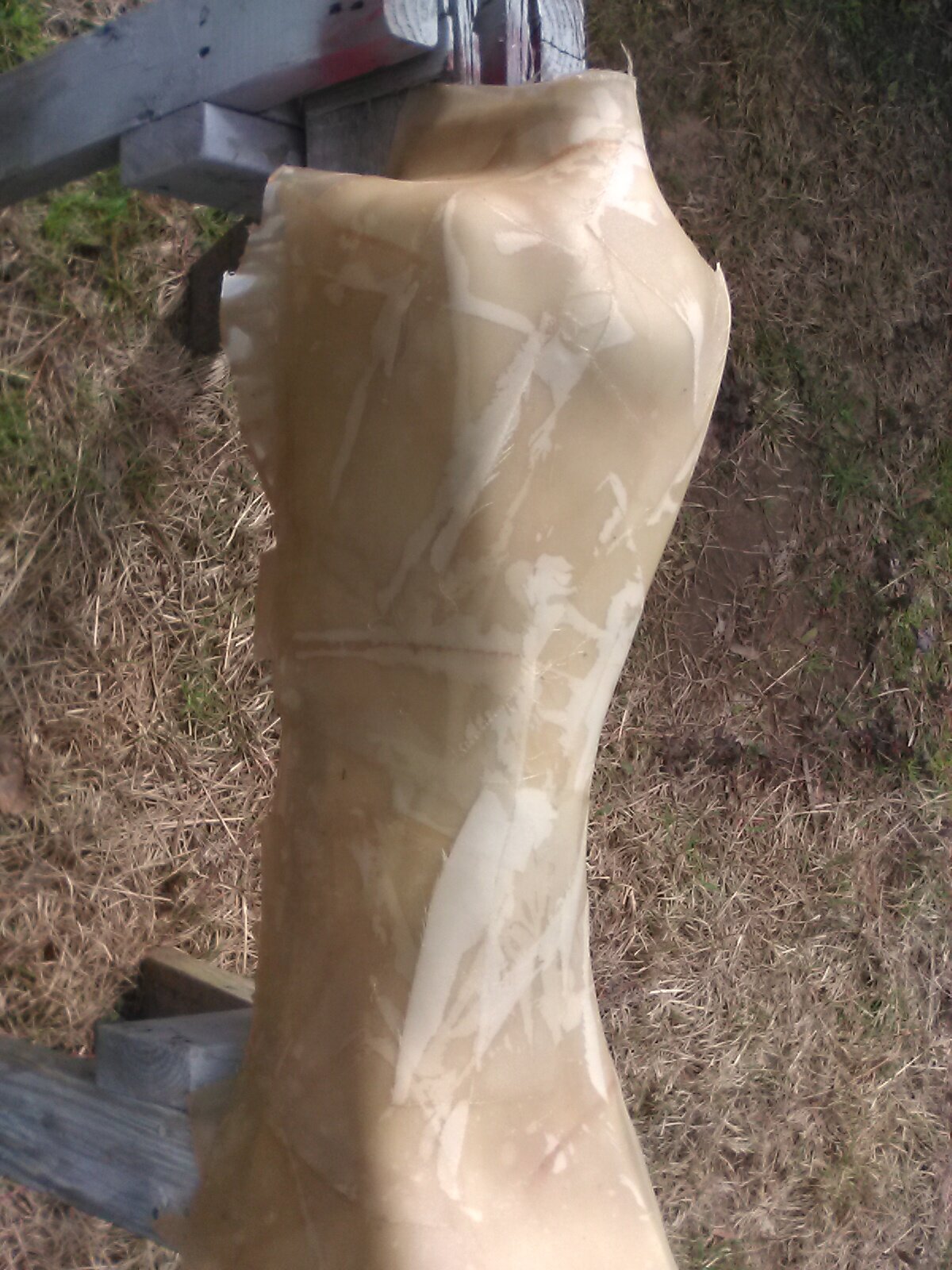

And then this happened, that is a mold for the custom carbon fiber tank shell and the mini tank that goes under it

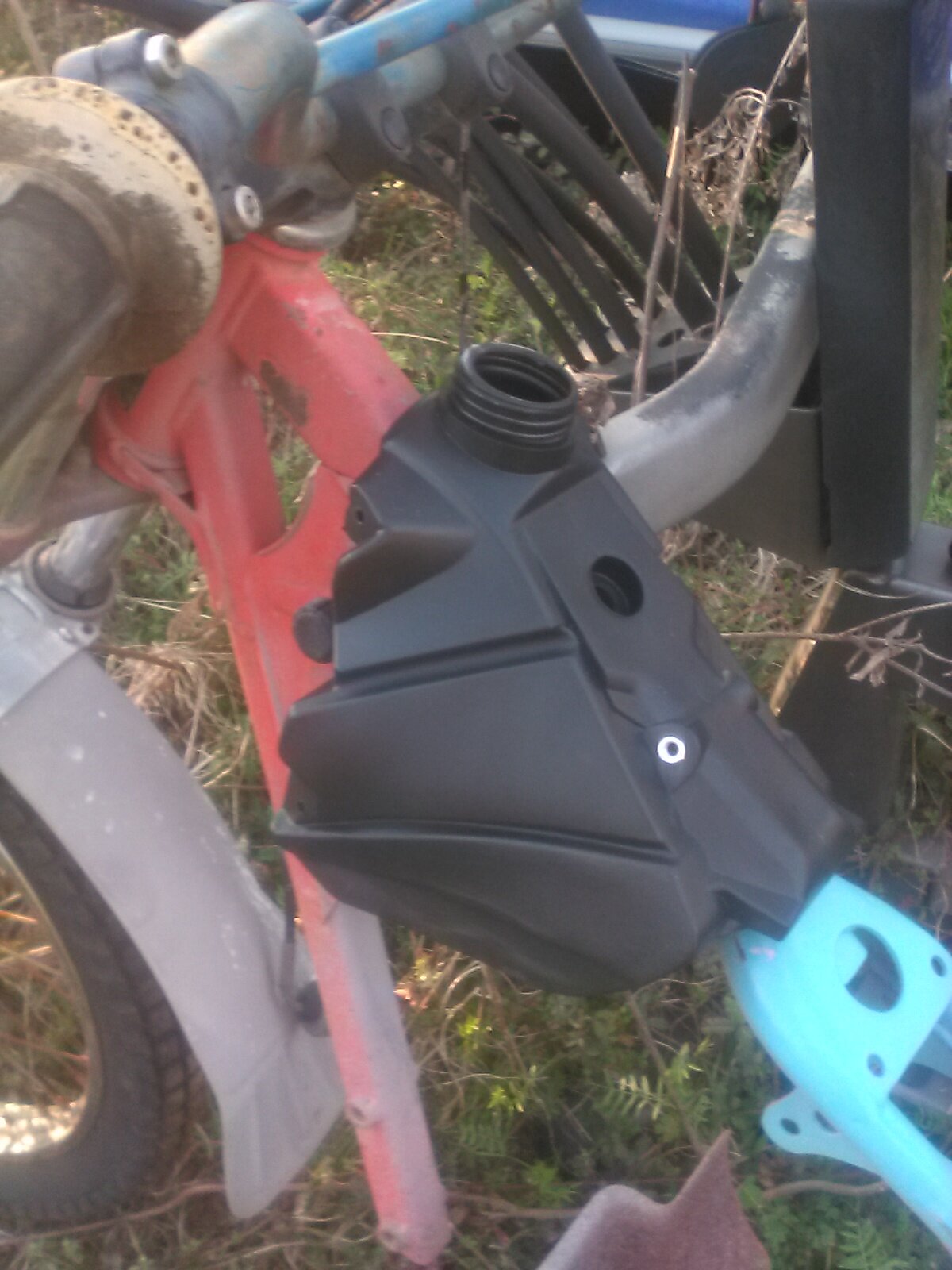

So if i get this correct ... that's the mold you are going to use to build it with carbon fiber right?  you will keep posting pictures of the progress I hope:-)
So from the seat  mold you then use the original tank to build it or the mini tank? is that mini tank form a particular pit bike like a KTM 50? what kind of fiberglass you use to make the mold?  is just looks so clean and thin !!!!
Yes that's the mold in the pic, type of fiberglass does not really matter unless you are doing a production mold that will be making many parts, yes I had an old beater tank that was crusty and rusty, I also had the fiberglass seat piece I had already made, I just combined the two, the plastic tank is off a Ktm 50. Those last two pics were of the plug the mold was made from. I will be posting pics I am making the shell out of carbo fiber , it won't be visual carbon , it will be painted.
