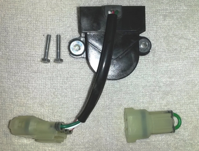

Sorry to dredge up an old thread, but since Ive discovered what some of the 4RT electrical connectors are, I thought Id share this info with anyone wanting to remove their bank angle sensor without butchering anything and allowing it to be re-fitted (for what reason I dont know). As mentioned above, if youve fitted a lanyard kill switch you can save 110 grams by removing the bank angle sensor. But you need to link the earth and sense wires together.
The original connector is a Sumitomo HM-090 series. These are nice fully sealed connectors if not a little on the large side. Where can you get them? Well I dont want to fall foul of the admin here but if you google "cycle terminal" you will find the supplier I used and hes great genuine connectors, cheap prices, cheap and fast postage.
For linking out the B/A sensor, you need the 3 pin male half only (Male HM090-3) which comes with terminals and seals. You also need one HM Connector Cavity Plug (Plug 090) to seal the unused centre pin. Simply wire the two outer terminals together as shown below. Then remove the B/A sensor from above the rectifier/regulator. You need to remove the air box first. The mounting screws are 7mm hex head. The connector is under the large vinyl boot above the front sprocket.
