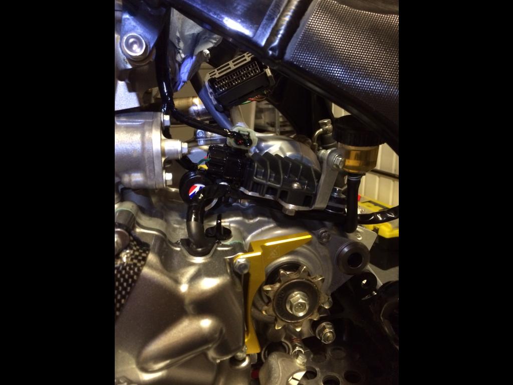

On 5/9/2014 at 6:14 PM, jj65 said:
The angle sensor is not a good emergency engine kill switch, the engine will run for quite a few seconds before shutting off. I've removed on all my bikes, use a lanyard kill switch. Whilst removing it, you can take the opportunity to get rid of a lot of weight and tidy that area up, get a future condenser from H&D and junk the massive Honda one. The future alloy fuel bases and carbon hose, alloy banjos are a good upgrade too. I use a T Miles alloy base for the rectifier as below. You can also see what I did with the bank sensor wires.
Nice tidy job that
£70 for the carbon bracket on H&D, im going to have a go at fabricating an ali one, ill keep you posted:
134602_2b97a877ef8d41ef833ed29e13c632a2~
