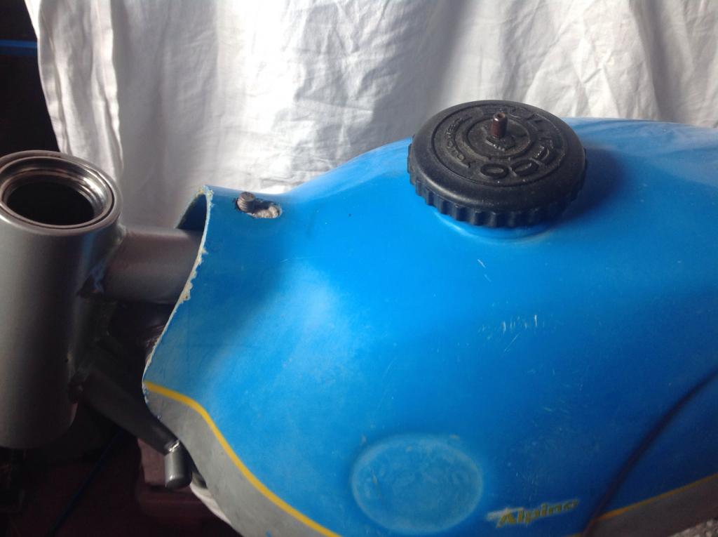

September 17, 201412 yr Does anyone know about how the gas tank mounts on a 71 Alpina. Specifically the end of the tank where the side panels are joined to the tank. My tank has some stress fractures in that area causing it to leak. Before I remount the tank I need to know exactly how it should mount. On my bike and what i suspect is the cause of the stress... the air box was not fully resting down in the cavity between the frame tubing. It was sticking up about a half an inch. I think the tank was partially resting on the airbox, and not fully seated on the frame, causing it to seat at a slight angle. I think this may have stressed the tank. I have since fitted the airbox so that it now is below the level of the frame. I am hoping this solves the problem. Anyone have any pictures or comments on this? Thanks!

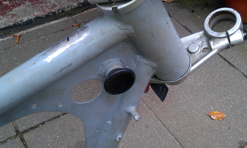

September 23, 201412 yr Hi Philip, Mine has three fixing points, one on the top frame and two on the rear. See pictures hope this helps? Mark
