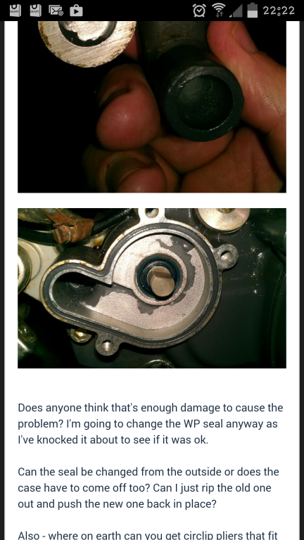

This is what my casing looks like with the hole on the left of the water pump casing but this is a picture of a 2001 engine just so every one knows what im on about as it may not make sense what im on about thanks ian

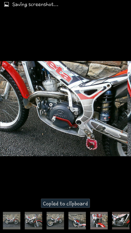

And a pic of the outer cover with the two coolant pipes
And a pic of the outer cover with the two coolant pipes . So i'm not sure what's going on as the new cases for the 06 rev don't have the hole in it its blanked off .
