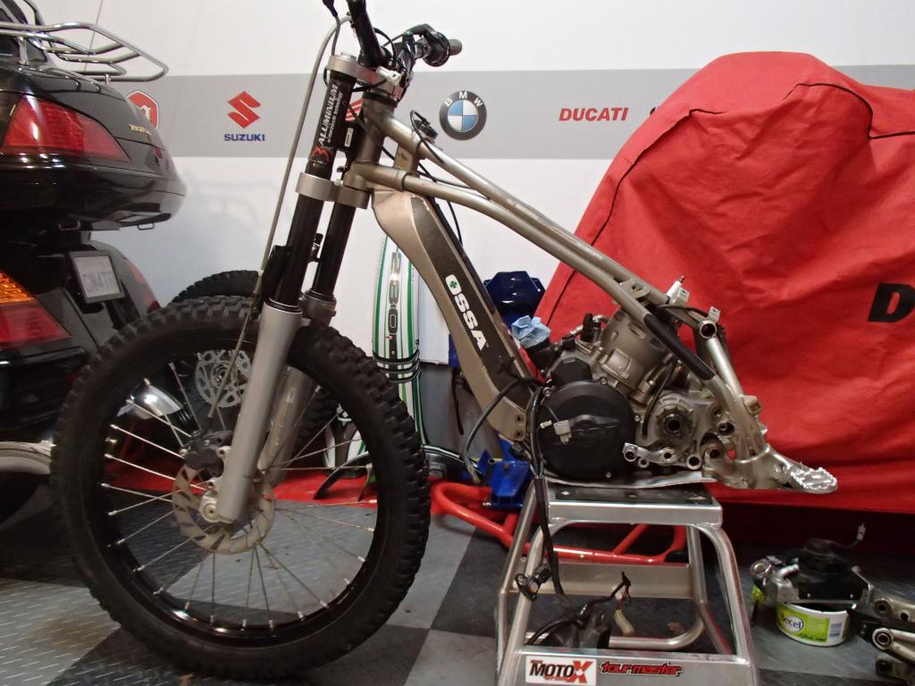

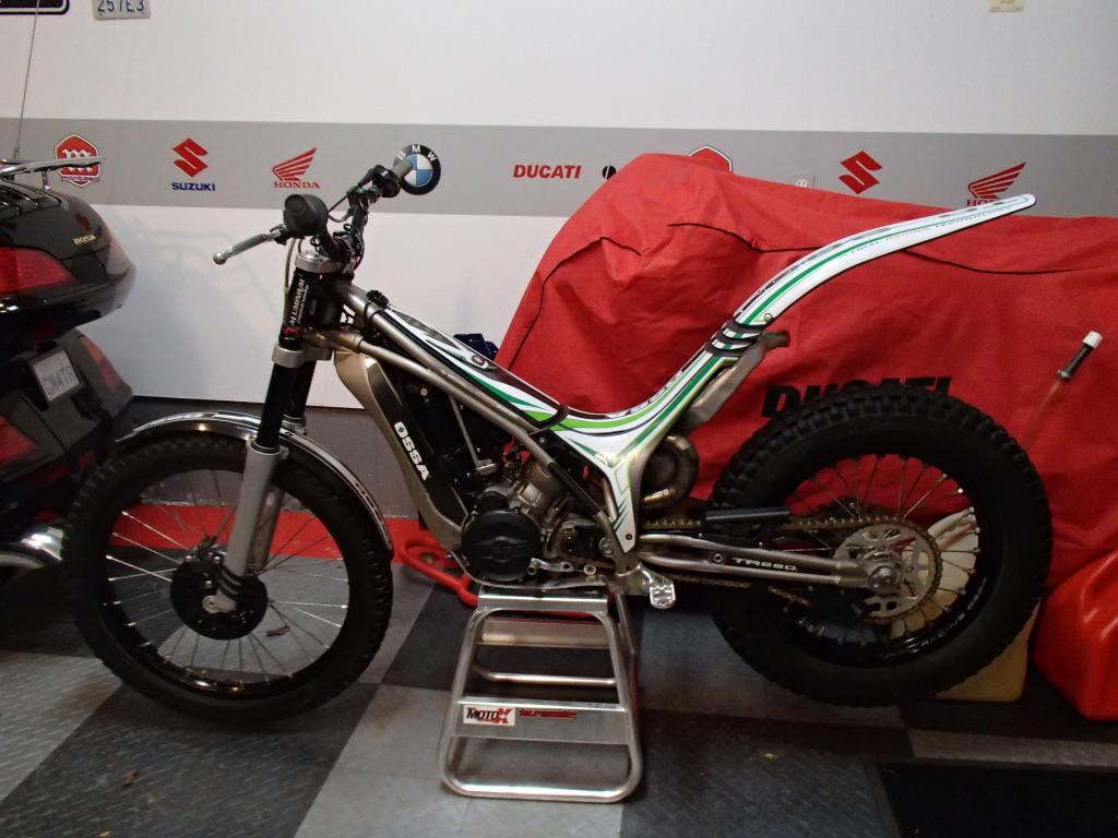

It's looking a bit ratty and I want to do a couple of things to the bike to make it more suitable to me.the frame is going to get a black powdercoat,the triples are getting black anodizing and i'll change the airbox cover for the new style vented one.I'm going to try and see if I can get a 2015 sticker set for it if it will fit the 2011 plastics.Might have to get a newer seat base and bendy rear fender.While the engine is out,another base gasket is going in to make it easier to kick thru.I doubt it will effect low end power,but I might lose top end.Never use all of it anyway.

  • All done.That was a project! It runs great.I can tell there is a new piston and cylinder in there for sure.The extra base gasket makes a little bit of a difference in the force needed to kick it thru.

The Spaniards that put this together must be "rubiks cube" masters.It was really tricky getting the motor out of the frame.Gonna have to be super careful putting it back into the fresh powdercoat finish.
The triple clamps and footpegs would be off if some idjit hadn't used a bit too much Loctite on em.Duh.Later...beer me!
This was supposed to be a "cosmetic" makeover.NOT ANYMORE!!!!!! GRRRRR!!!!!

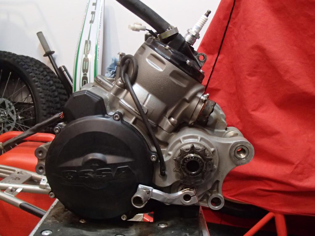

How bad is the bore ric?
The piston material should come off with some acid.Doesn't look as bad as the pic.Most of the dark stuff just wipes off.I'll have to measure it and see if it's out of round.I know where I can get an almost new barrel tho.It was running so good!!??
When I had the overheating issue I richened my mix up a little to 100:1 (just in case) and did not notice any difference in performance, or oiling up etc
Is that the intake side? Maybe something foreign got sucked in as I thought the exhaust side was always more prone to that sort of damage
I will run 100/1 from now on I think.Spark plugs are cheap.Yes,it's the intake side.I'm going to have a real good look in the crackcase (as best as I can) for any dbris.It does look like foreign matter.I'm very fussy about cleanliness during filter cleaning.I thought the exhaust side was more prone too.
