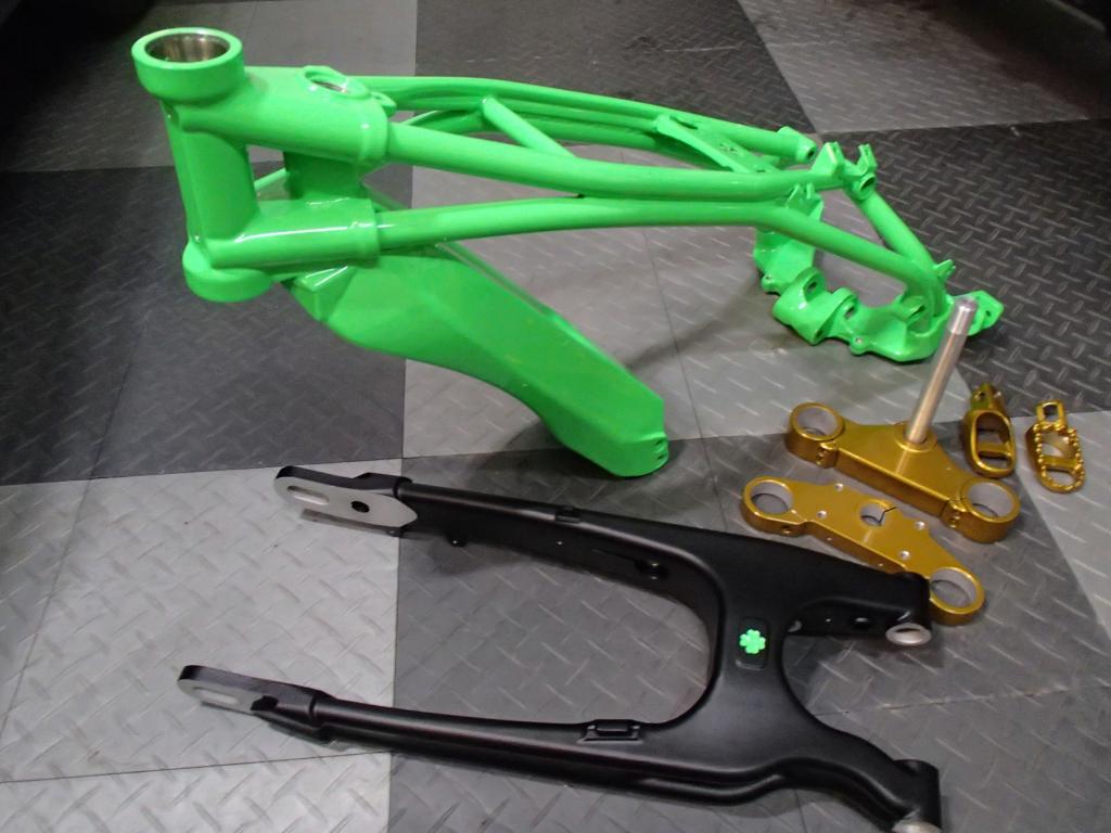

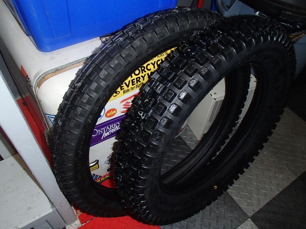

Frame,swingarm,triple clamps and footpegs are at the powdercoater.Time to mount new tires.

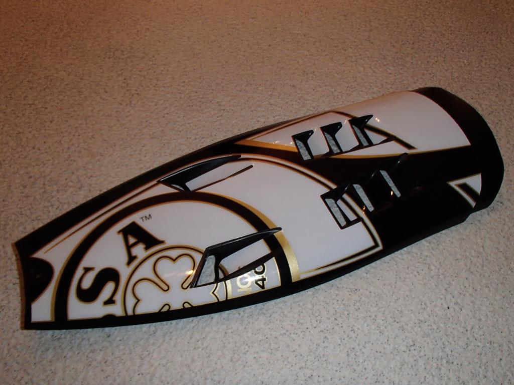

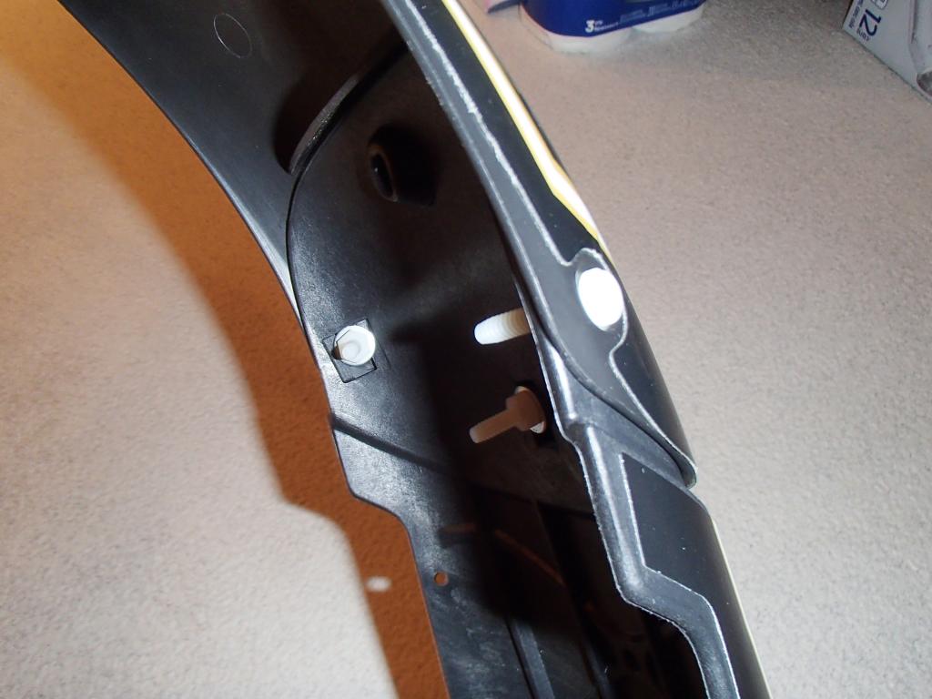

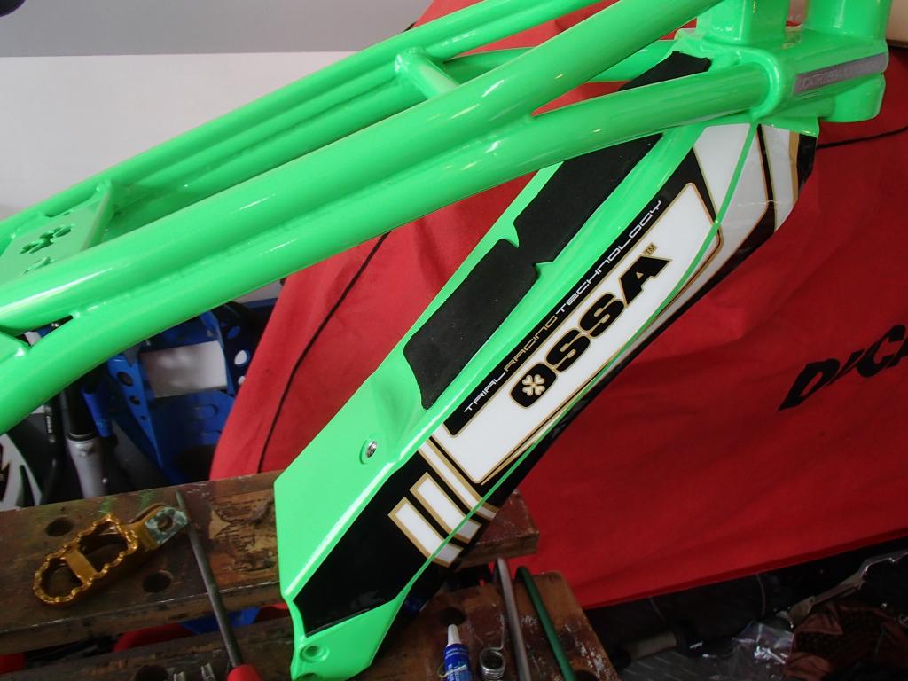

New plastics and stickers together.Used plastic bolts for the rear fender (trimmed the bolts with sidecutters).The airbox cover was unavailable in Canada,so it came from Zonetrial in Belgium in 5 days!

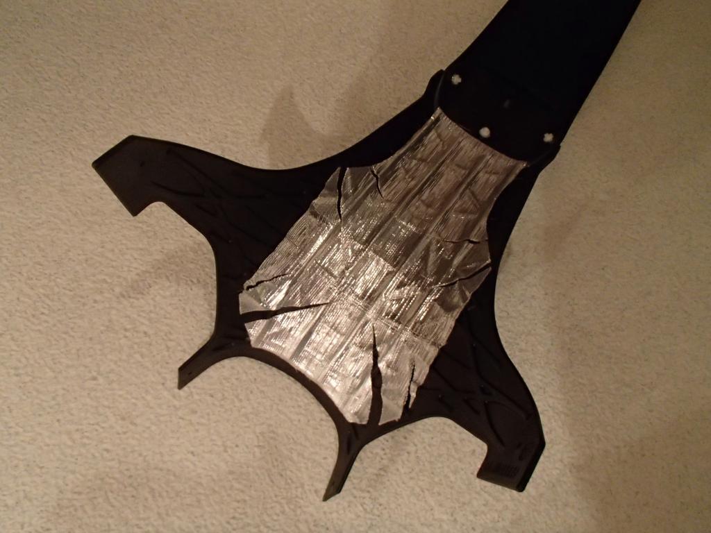

Cut a heat shield for the seat base.Material is from Moose Racing via Royal Distributing.

Swingarm powdercoat is looking really cool.
  • 3 weeks later...
Powdercoat is done.Work begins now.
Gas tank stickers and the airbox pad while i can still flip it around with the heat gun smoothing them out.https://www.facebook.com/johnny.p.332'spowdercoat is awesome!

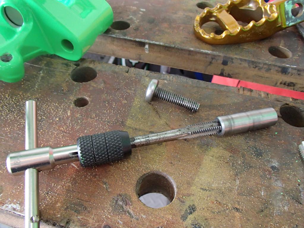

The footpeg pivot screws and shafts were assembled with waaaaay too much loctite at the factory.I had to wire wheel the screws and chase the pivots with a tap.

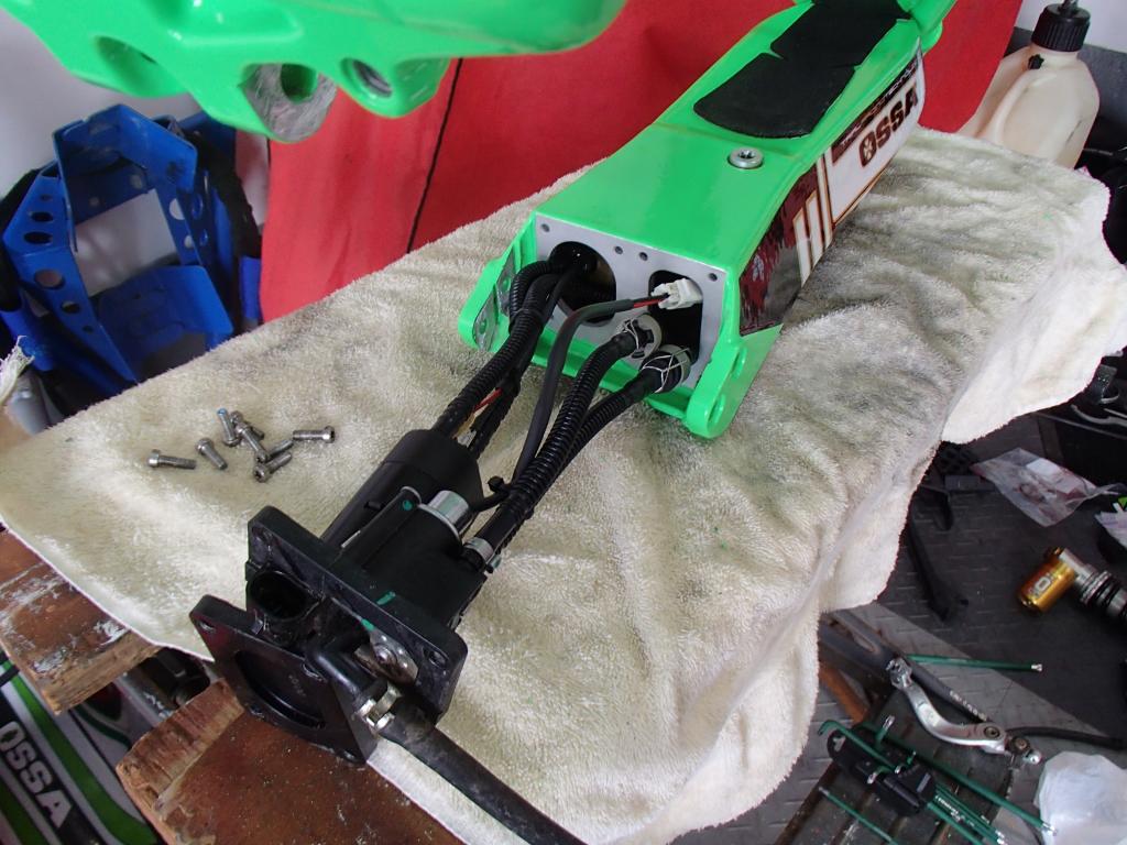

If the fuel system were a little smaller,maybe the gas tank would hold more than 3 liters.

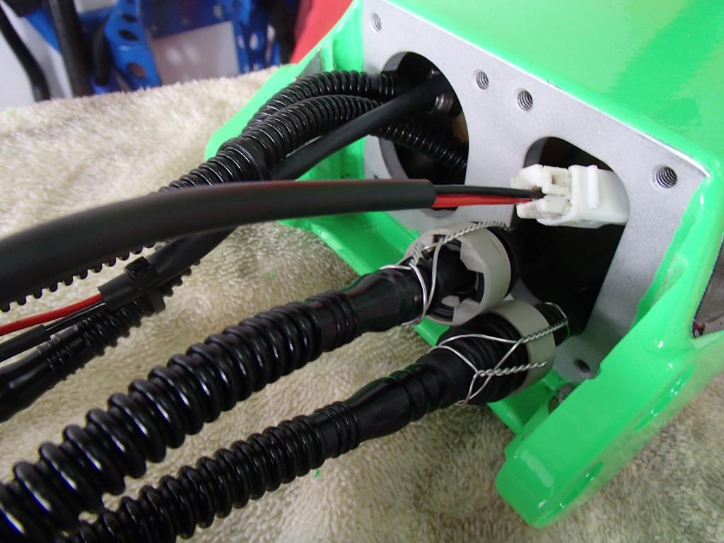

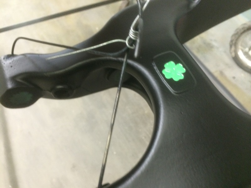

Lockwired the fuel line connectors.I'm NOT pulling the motor to reconnect a goofy fitting.

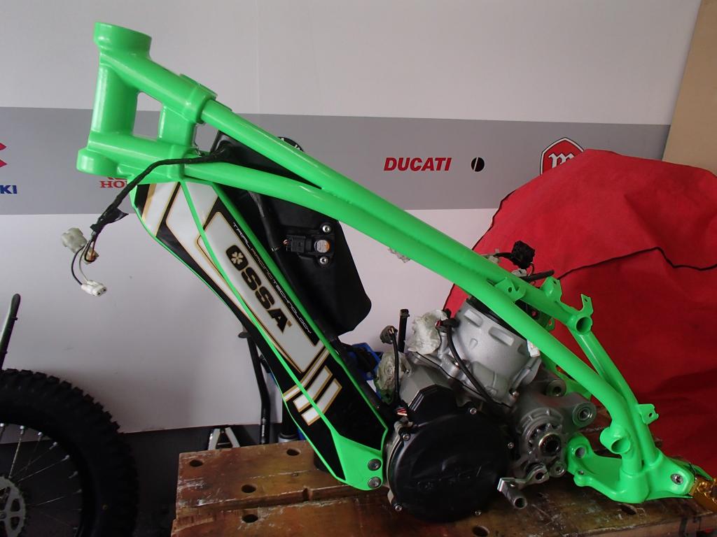

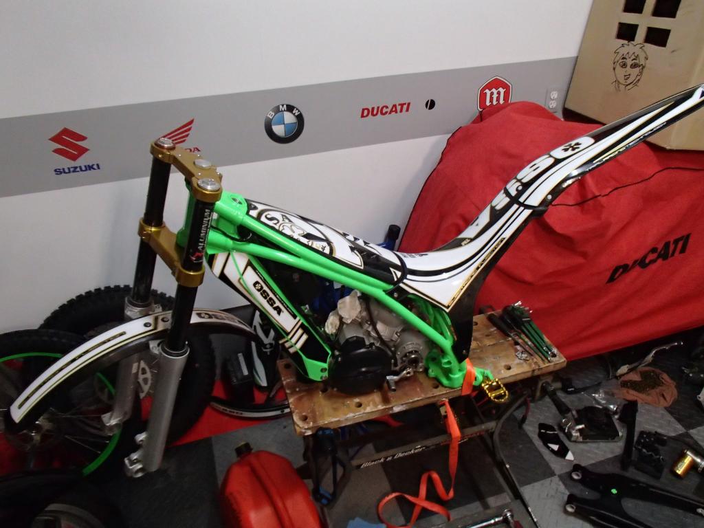

Progress! Motor,airbox and wiring is in.

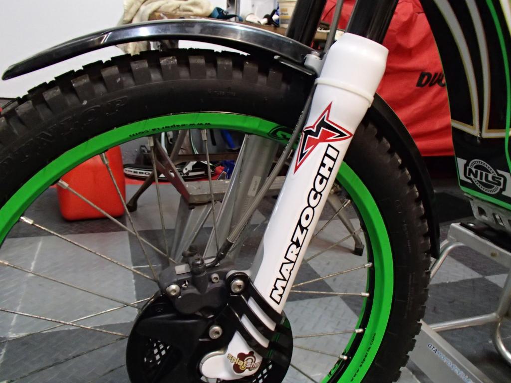

Front end is on with new bearings.Tried the new plastics on just for giggles.

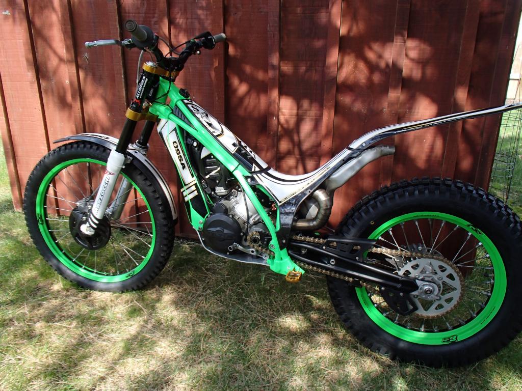

All done.That was a project! It runs great.I can tell there is a new piston and cylinder in there for sure.The extra base gasket makes a little bit of a difference in the force needed to kick it thru.Just what i wanted. :)
Powdercoat by my friend JohnnyP is second to none.
Stickers by Trackside Cuts of London Ontario.

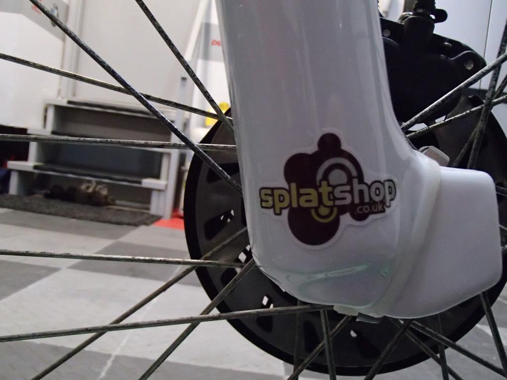

Fork guards by the SplatShop.

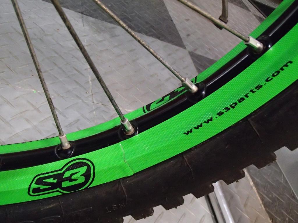

S3 Rim Transformers from RYP.

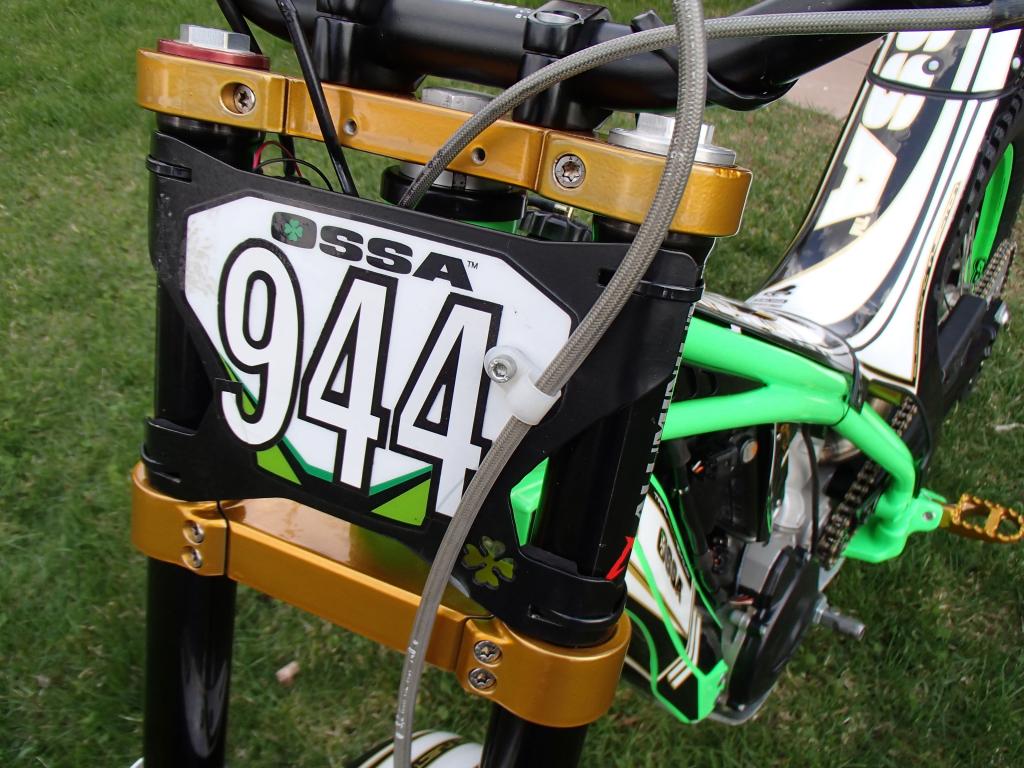

SplatShop frameguards.I didn't do this much work just to watch my boots wreck the cool powdercoat.
I also put a couple of chunks of 3M paint protection film over the side plastics.
