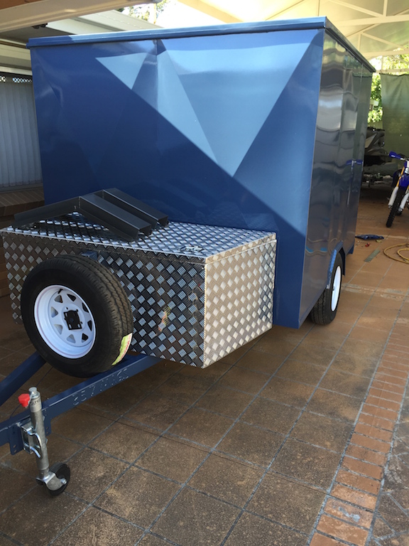

Spent some time with a trailer manufacturer to design a trailer for our trials, enduro and road bikes.
Criteria was...

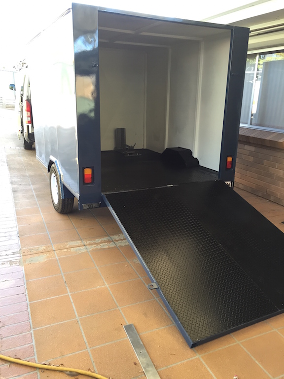

Single axle with disc brakes, 1400kg capacity, tare weight around 500kg, longish drawbar with big gear box and lockable, wide ramp to ride bikes into trailer, fully enclosed. 2 bike capacity normal with 4 in when needed, recessed tie-down pionts as we want to sleep inside at trials events and not stub toes, fully painted outside and underneath, new wheels and tyres not second hand, led lights and full registration for road.
We have achieved our goal and it came in just over $10,000 aussie or about $7000 eurodollars.
We will mainly use the trailer for trials and enduro overnight stays so will attach an awning and sleep on camp stretchers inside the trailer with bikes under awning.
The box for riding gear on the front is huge and takes the helmets, boots and gear easily.

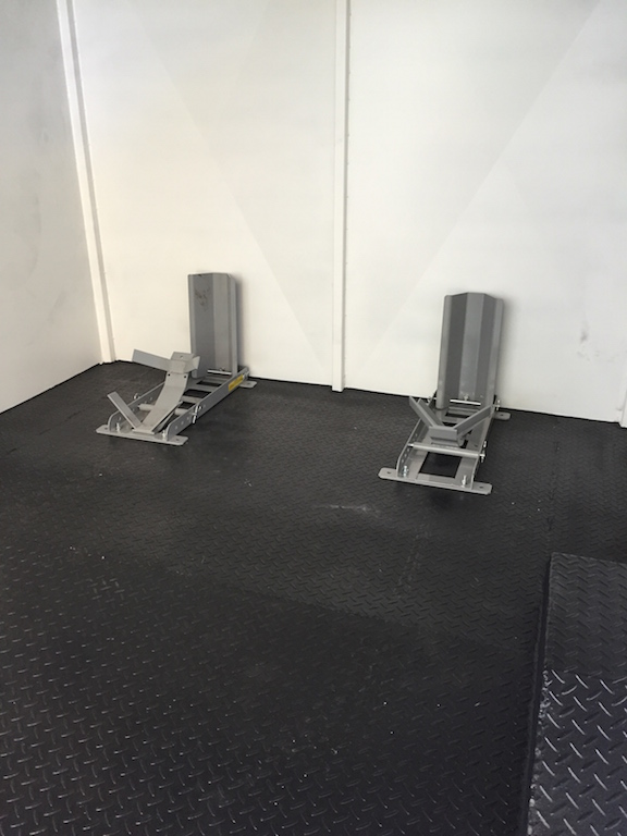

In the pics the tie-down shackles are not fitted in the floor and thats what holds the rear wheels down. The front wheel in the cradle with two tie-downs and the rear held with one. I'm looking into fitting a removable channel for rear wheels that has a heavy dog collar type strap to hold rear wheel. Also looking into a rear wheel cradle tie-down with tensioner.
It was a little on the expensive side I suppose but it is 1.4 tonnes legal and disc braked. The lockable ally box on the front was $1000 alone, they are $1600 retail.
Painting is done with two pack marine (Jotun) and it is painted and sealed underneath as well, that cost fair bit extra. Spent a week at ally boat refinisher.
The rear door is sprung like a horse float so the door can be raised without a hernia.
Its axle centre length from tow point has been properly designed and set for correct ball weight when loaded... it tows beautifully at 120kph loaded or empty.
Axle, springs, wheels and chassis are heavy duty and should see years of service. The maker has a similar trailer at the factory that has been sitting outside for 8 years. It looks the same still but just has medium faded paint. Mine is under cover at home.

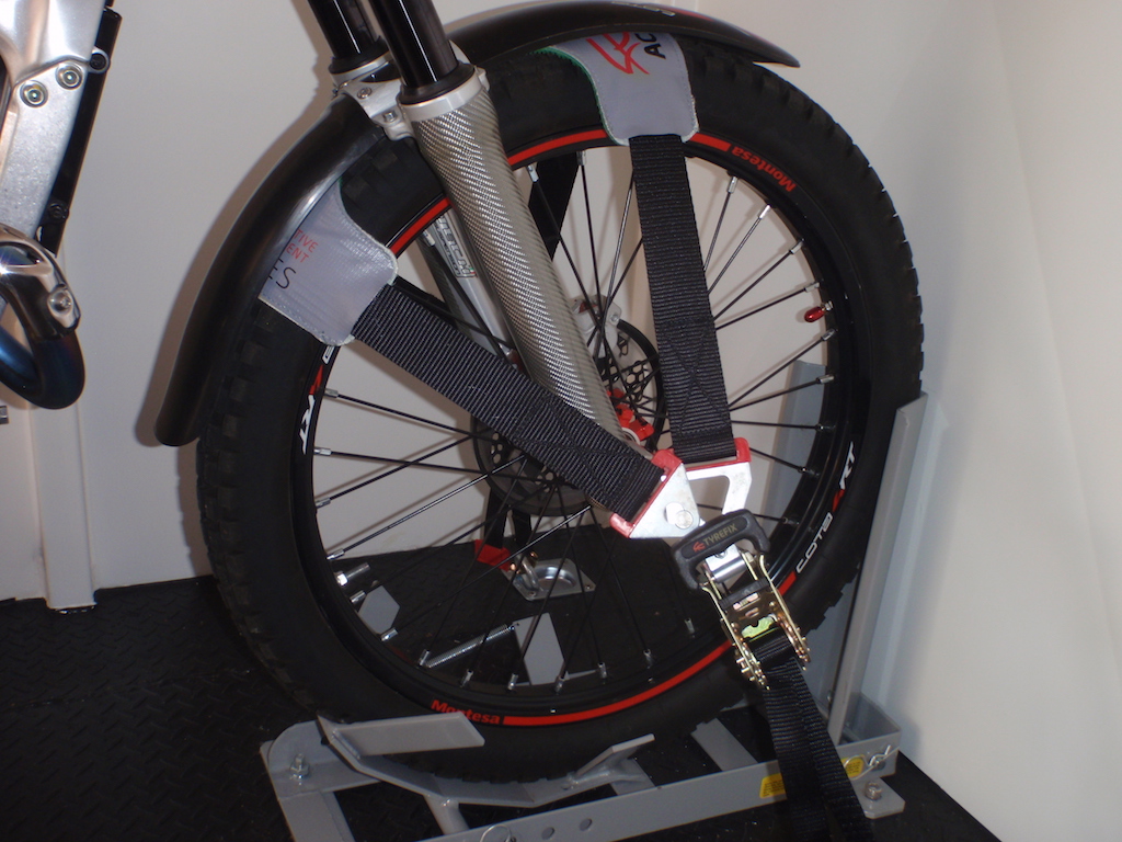

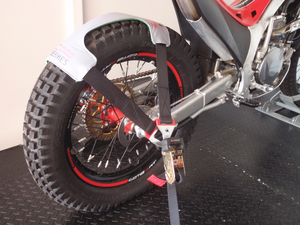

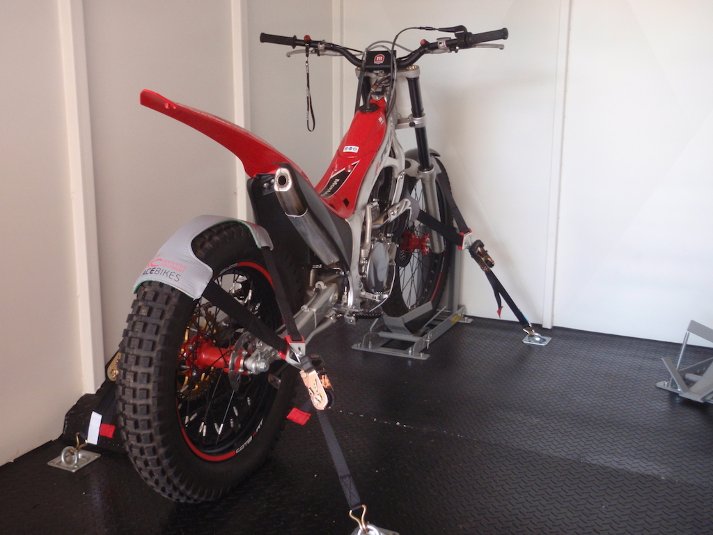

I have a few pics of best system I've found to hold bikes down. The straps dont compress suspension as they use a tyre gripper pad and ratchets.

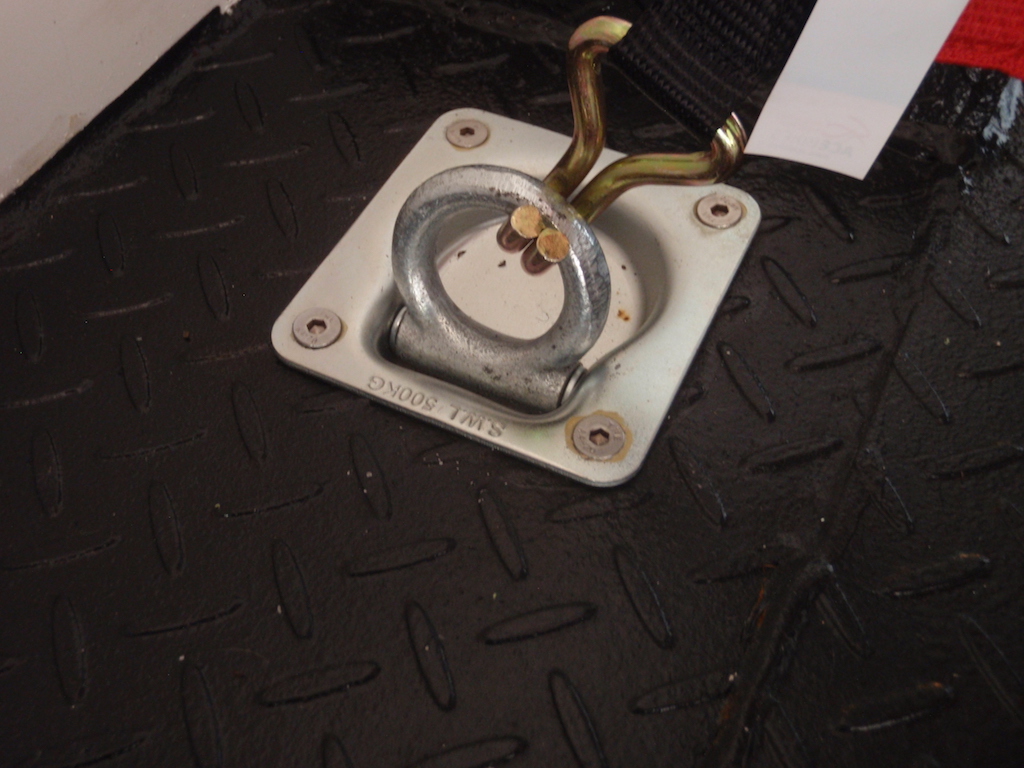

Also a pic of the 8 flush mount floor rings. The ring fold down when not in use so you dont stub toe!!!
Bike also stand upright when it locks into front tyre mount (grey wheel holder/chock) no need to hold or use side stand while you attach straps... so one man job!

I use these http://motocinch.com/products/off-road they only compress the suspension a little bit and the bike becomes part of the trailer . I've had more than one tie-down strap self destruct , I just don't trust them anymore .
But your tire grippers are cool , never seen them before . Just alot to clean up after a muddy day ...

Those motocinch look great! Probably $500 plus for two sets landed here? The guy who makes them passed away and the company stopped making them????
The straps will be a pain to clean but we only ride mud once or twice a year... mostly dry terrain where we practice.
