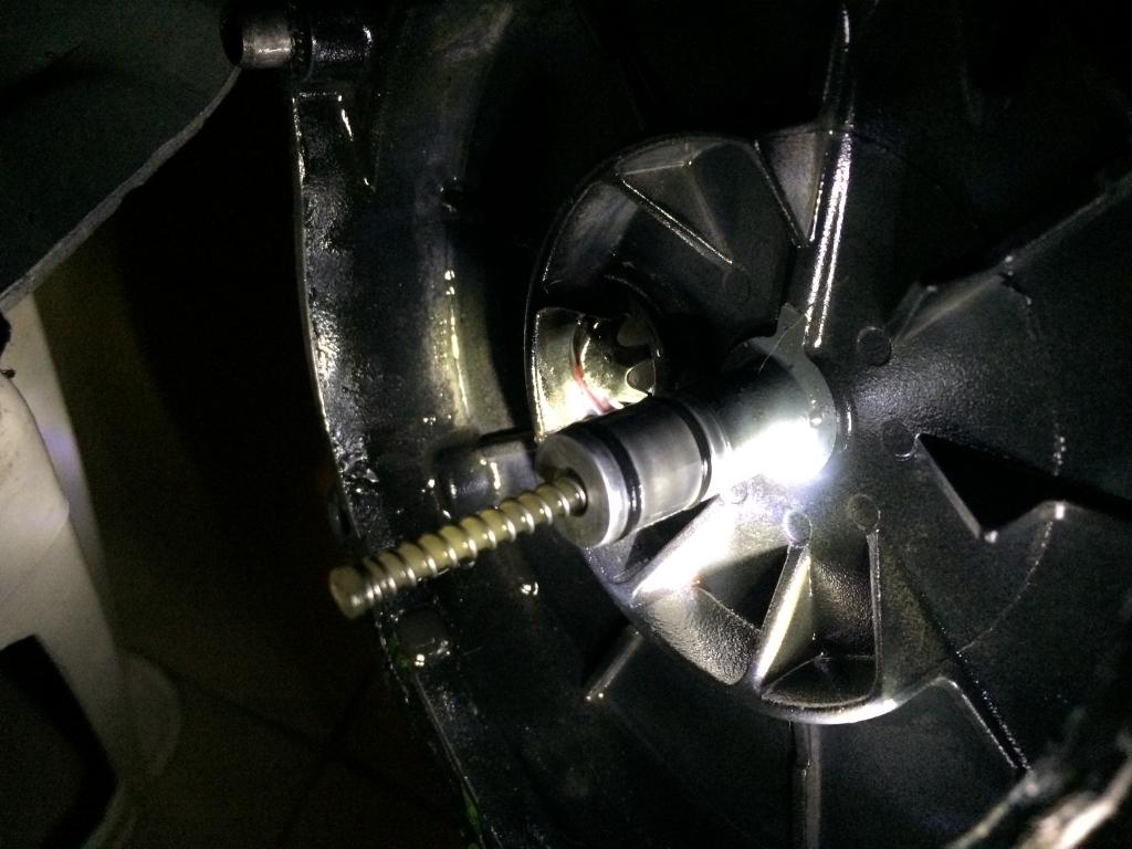

Hi everyone,
Just stripped my clutch down to see what parts need ordering to cure my clutch drag/difficult starting/noisy kick. I think the bike is a 2003, but understand the 2002 has a different clutch set up so need to be sure (gas gas website only has parts diagrams for 01 or 03). Been looking at the Jim Snell videos, my clutch cover o-rings look similar in size, as per the 2002, however the interior of the cover and the slave spring match more with 2003. I may be wrong though.

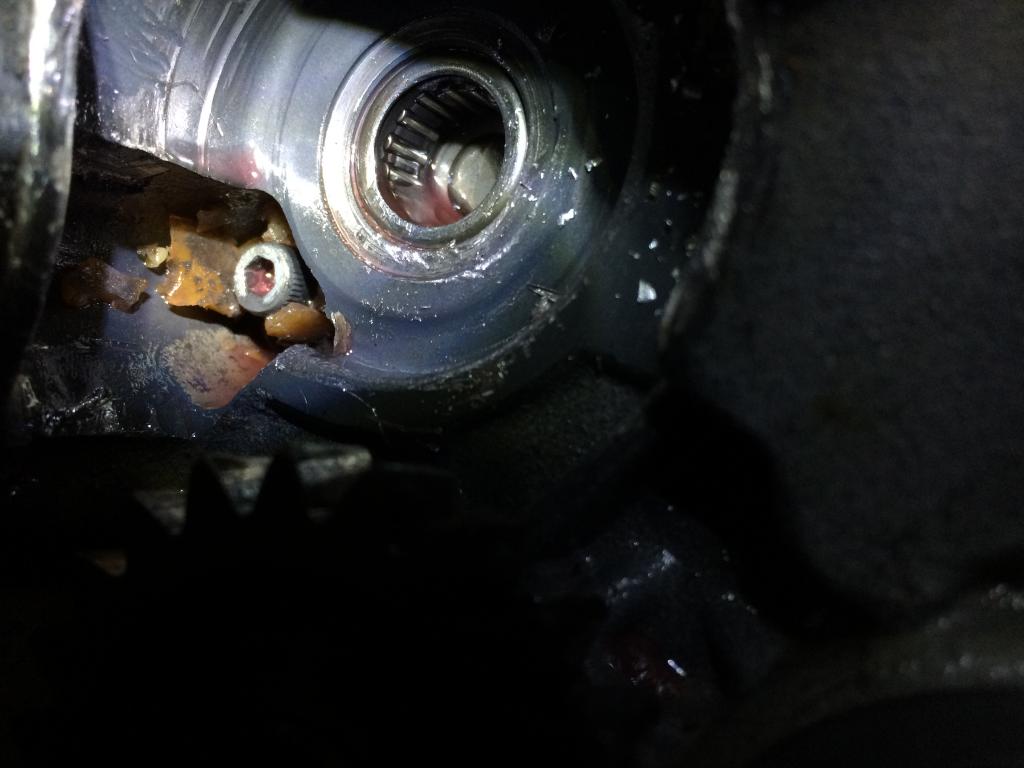

Also, there is a broken up plastic part under the kick start shaft bearing, no idea what it is and if it might have been related to my problems?!

The plastic thing is the kickstarter stop

There seems to be quite a lot of particles in the engine? Is it from the idle gear/kickstart gear?
MT280226011

Thanks for your reply. I should have mentioned, the particles are from the starter gear....2 missing teeth!  Will do my measurements later and see what I find.

Quick update....found my clutch pack is 10.20mm and finger height at 11.90mm. So, I'll start by shaving 0.3mm from a clutch metal plate which should give me an extra 6mm finger height and a nice light clutch! Happy I've found the 3 problems (broken starter gear, broken starter stopper and out of spec clutch thickness). Nothing worse than stripping something down and not finding anything!
