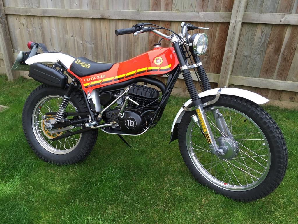

Hi Guys,
I am after some advice regarding my 1979 Mk1 349. I am about 98% finished with my restoration but I have a slight issue with it. I have a new Mikuni carb fitted instead of the Amal. It starts and ticks over great. If I rev it a little bit it comes back to idle nicely. If I open the throttle fully and release it, the revs hold for 4 or 5 seconds before returning to idle. Throttle cable is not sticking and I can hear the slide in the carb returning onto the throttle stop screw.
I have tried the clip on the needle in different positions but it is still the same. Is this a fuelling issue or is it sounding like crank seals? The crank seals were supposed to have been replaced before I got the bike, but you never know! Am I right in thinking that when the revs hold it is running lean? Or is this normal? I have never had one before so I don't really know what it should do haha
I have a short video clip I could email to somebody if that would help diagnose the problem.
I don't think that you have a problem with the seals. It sounds as you'd need a bigger slow jet.
Do you know the exact settings you're currently using for the Mikuni? In my experience, those carbs work very fine, but can be a little tricky to adjust.
Very nice looking bike, if you are going to ride trials with it you may find it steers better with the bars pushed further forward, take a look at how others have their bars positioned.
The carb was supposed to be jetted to suit the bike so I am not sure what is in there. I know the needle is a 5DP7, but I think I will have to strip it down to find out the rest.
The Mikuni is brand new.
I have just stripped the carb to see what was in there!
Slide  - 2.0
Main Jet  - 130
Pilot Jet  - 32.5
Needle  - 5DP7
Needle Jet  - 182 0-8
Main Air Jet  - 1.7
From a google search I found somebody running the same apart from he had a 35 Pilot jet.
For a Cota 330, we used a Mikuni VM 28 with these settings:
Main jet: 130
Pilot jet: 40
Needle jet: 169-O0
Needle: 5F21
Slide: 2,5
Air screw, 1 and 1/2 turns.
Don't ask me why, but we found a tremendous change between 35 to 40 pilot jet ... from 3/4 to full throttle! But it's my only experience dealing with Mikunis. I can't tell you if it is a general rule.
PS: Sorry, I forgot to tell you that those settings are being currently used at 600 metres above the sea level.
