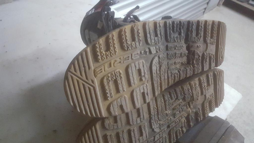

I have a pair of Gaerne Balanced oil - after approx 3 months of riding once or twice a weeks the soles are holed !!
My footpegs are in decent nick.
Has anyone else had this problem ? I emailed Gaernes website and got no response,What should I get next ? certainly wont be Balanced oils, which is a shame cos they are lovely.

Not all foot pegs are gentle on the soles. I would bet it`s the aftermarket pegs, as a set of Gaerne`s usually last 2-3 years!

I don't want to be disrespectful but how much do you weigh?
A guy in our club, who weighs around 100 kg, wears a pair of Alpinestars out, in about a year.
And what kind of foot pegs do you have? The aluminium ones with grub screws (S3 Hard Rock for instance) like to nibble away at the boot sole.

The pegs were on my old bike that has gone px to the same shop I bought the boots from - it had s3 hardrock pegs on - no fancy studs and pretty worn flat at that.
There are pics of boots attached.

I weigh about 88kg

Damn that looks bad.
The weight shouldn't be a problem.
Although the material of the foot pegs looks rather thin, so it wit cut easier through a sole, one would think more people would have this problem because I think it's a common used type of footpeg.
So as said, try to contact Gaerne first.
That looks like your leaning back a lot and cutting into the boot from one side (rear side) of the pegs?
If so that can be a result of not giving yourself enough room in the cockpit by having the handlebars to far back. Or having the rear brake adjusted to high.
Just thinking out loud...
My bars are if anything too far forward if anything apparently - but I agree looks like somethings wrong.

I have the same boots and got the same problem within a few months. I have s3 foot pegs and reckon they are the likely culprit.
Rather than spending money on replacement soles try - shoe goo  its a resin that you can fill the holes with and it lasts well. A large tube cost me around £15,  I've only had to re fill the holes a few times over the last twelve months and still have half the tube left. Its worth a try and a cheaper alternative than having the boots repaired professionally.
I've also used it around the front where the stitching has failed and it works well there also.
For the best results just make sure the boots are clean and dry, apply the goo and let it set over 72hours
