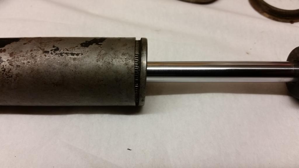

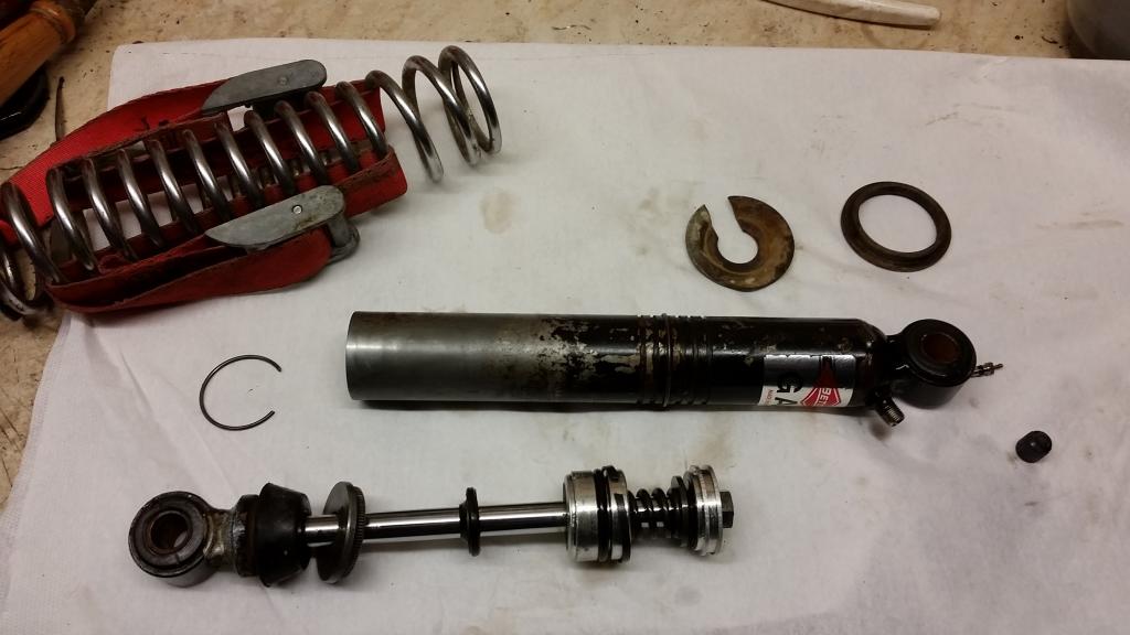

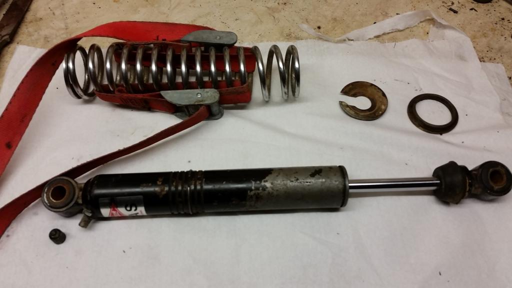

i have just rebuilt a pair of betor 360mm shocks and couldnt find any photos before i started so thought i would add some.
the photos seem to have been jumbled up and im too tired to sort them so the procedure was
  • compress spring with straps
  • remove collet
  • remove spring

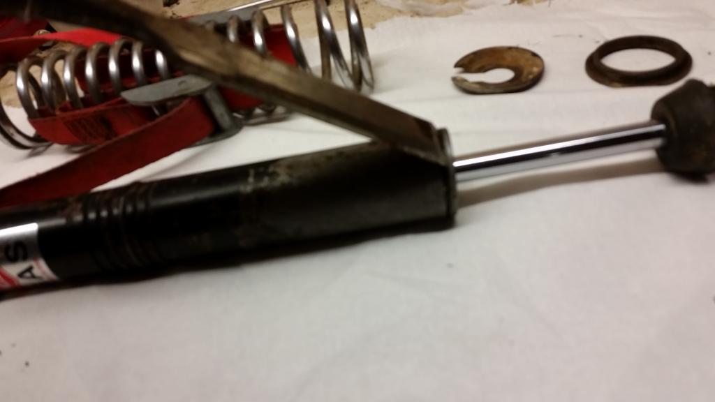

  • tap end cap off with chisel (carefully)
  • remove valve core and pour oil out of valve

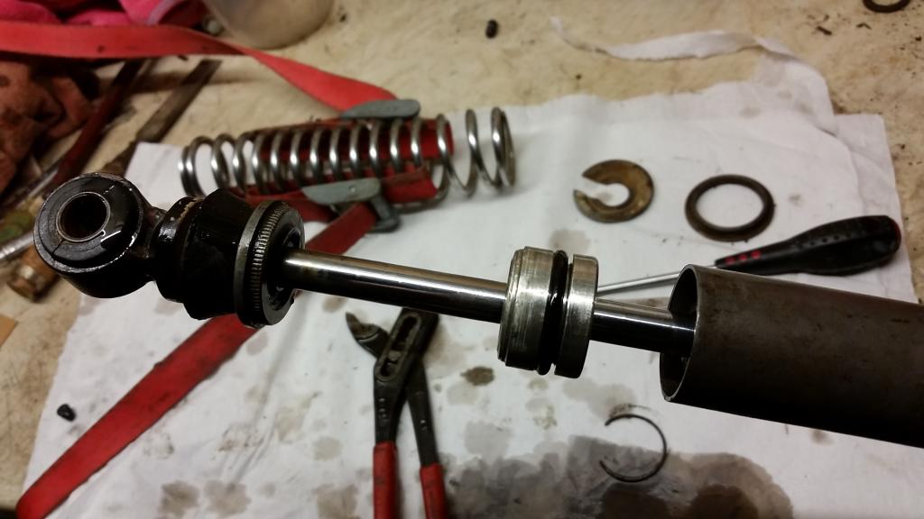

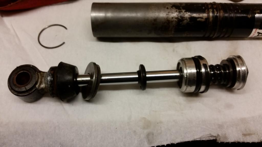

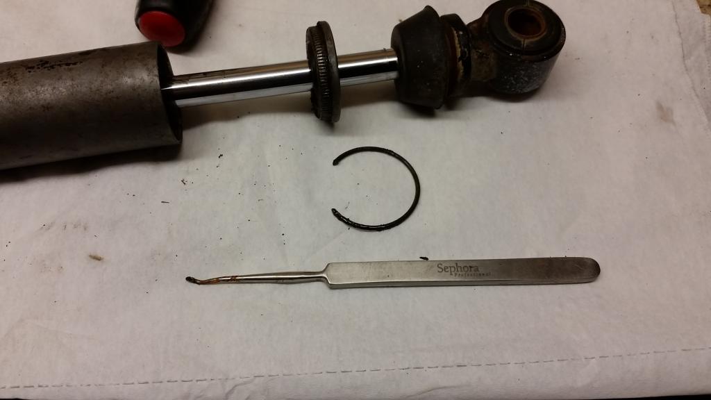

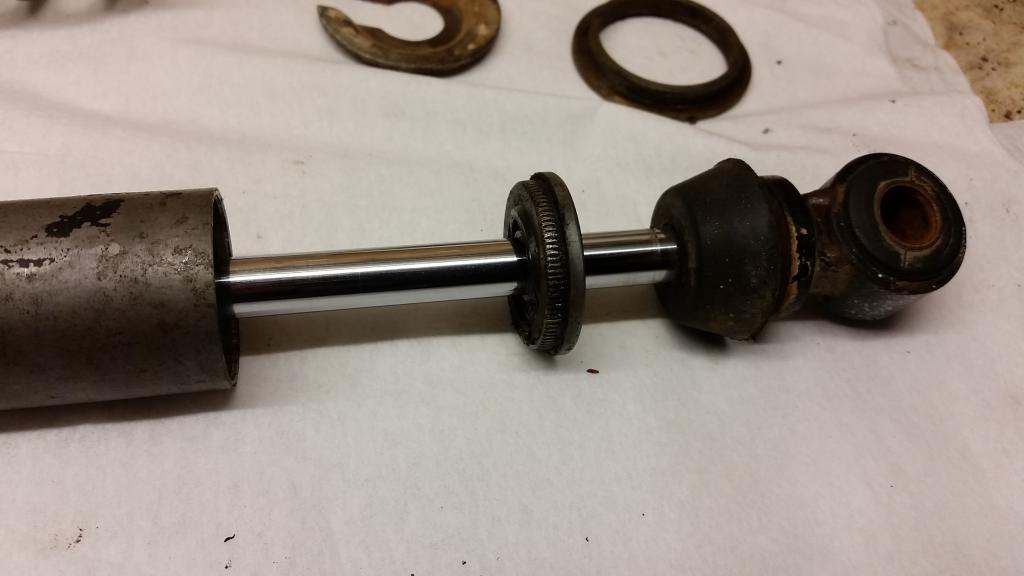

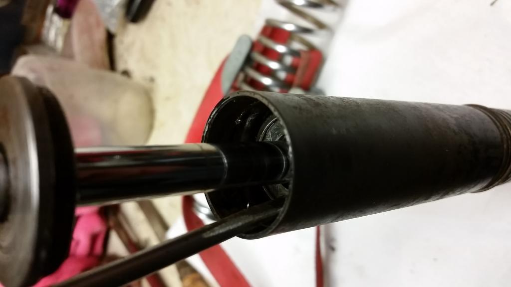

  • press damper into shock body and remove c clip
  • ​pull damper rod out of body, (this was quite difficult as the o ring on the damper got stuck in the c clip groove. I pressurised the body with the compressor and popped the first one out and pulled the second one like a slide hammer, both methods worked well.
