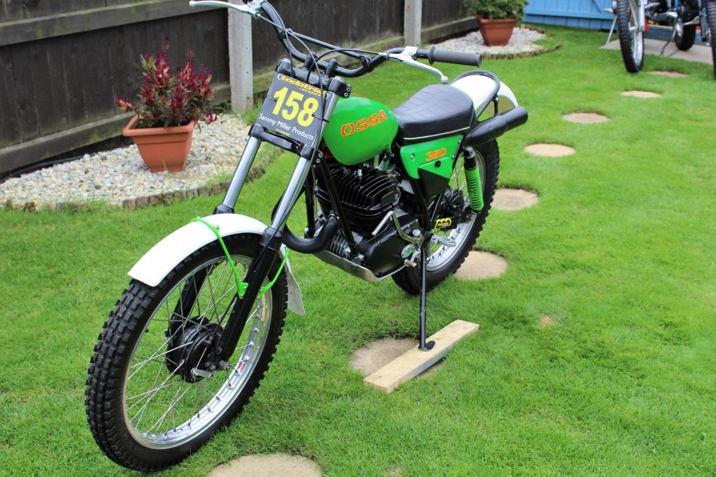

this is my ossa TR77 just finishished apart from needing new rear shocks.post-12321-0-98276800-1473413474_thumb.jpg

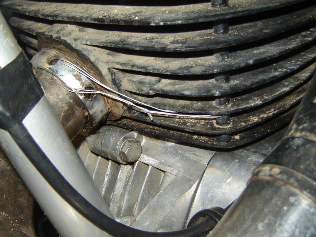

I got the idea from somewhere to safety wire it so it can,t turn.Mine is an older (1970) plonker and it has the post between the cylinder fins that I tied to,not sure if the later ones are the same.
As you can see I did a sloppy wiring job that needs tightening up so maybe it has not tried to come loose? Nice job on the bike!
hello scot thanks for the photo since posting my quetion i have done the lock wire mine has the post but there is  hole just above the ring in the finn so ive locked wired it to that. a freind uses a strong spring but you have to drill a  small  hole  in the Engine mount to hook it on but didnt want to drill any holes but it is a good idea ill see how i get on with it.
