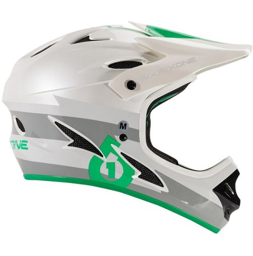

I'm guessing this must be the helmet Sean has as it fits the colour scheme he described?
Weight appears to be decent at 910 grams, decent ventilation too.
Incredibly, to me anyhow, there is/are no requirements for any test certificate or a type approval for trials riding helmet, the standing regs only state:
"Trials competitors may use any appropriate helmet."

Look at the picture of the full faced SSO helmet you posted above, see how it slopes down at the front???
If your friend Sean is wearing  a Six Six One then that is also a downhill bicycle helmet as Six Six One is  company that makes protection gear for the radical bicycle  guys.

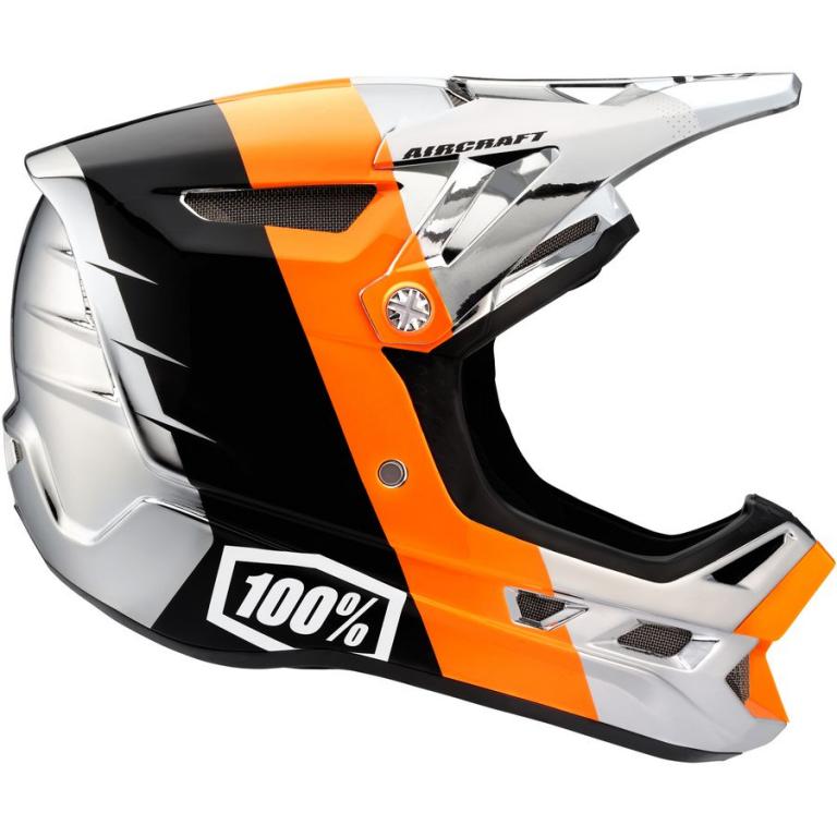

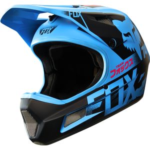

Some Down Hill Sanctioned Full Faced Helmets.  Notice how they slope down at the front........
