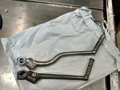

May 23, 20233 yr I know this is an old topic but I have the same problem on my 1975 TL250. It has cracked and been welded several times with no long lasting success. I do have a XL250 lever on it now but it does not have the length or bend to clear the foot peg. To use it I have a ty-wrap around the frame so when I need to start it I fold the peg up out of the way but then have to bend down to unhook it so the peg will flop down in the correct position. That gets me by but the added length on the lever also allows for a much easier kick. My 71 year old knee protests about that. 😁. It would be nice to know if there are any other levers, maybe even from newer bikes or other brands that would work. It's been a 4 year search and I haven't found anything other than the Honda XL250 that fits. Any ideas would be appreciated. I have up loaded a picture of the original vs. the XL250 one. LaVern
Sunday at 05:56 PM4 days Not as yet, I'm still watching and waiting. I did find a new one on CSML. Pretty pricy though. I still use the ty-wrap to hold the footpeg up out of the way, but sometimes I am able to give the footpeg good kick up and it will stay up, and then it just takes a nudge from my foot to push it back down. Unfortunately, it doesn't always stay up while trying to start it. LaVern
