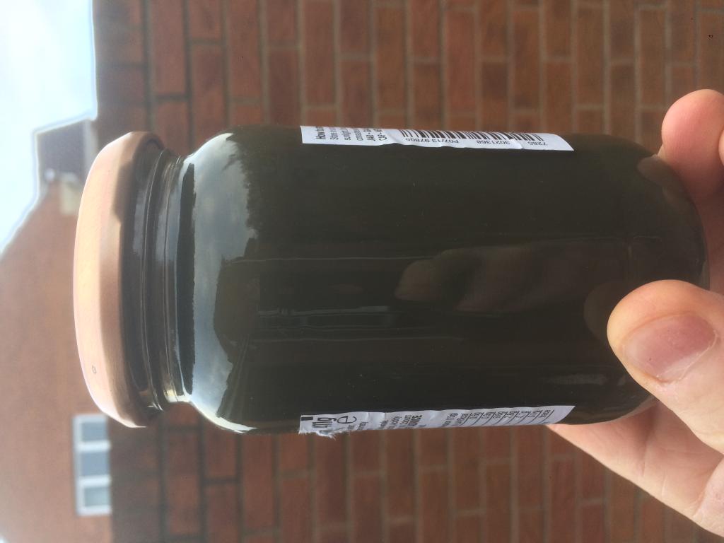

I changed the oil the other day and it was a funny colour
How do I upload a photo of it ?
Is it a diesel ? :huh:
how long had it been in there? were there any bits stuck to the drain bolt? any coolant loss?
I must admit it had been longer than usual, about 8 weeks since its last change, I've checked the coolant and it was fine
And there was a few tiny bits on the sump plug but not a lot
Is it a black jar?
No unfortunately it's clear
Clutch plate fibre breaking up?????
Fair chance your clutch has been slipping, this burns and darkens the oil as well as excessively wearing the clutch lining.
it only had a new clutch fitted in Feb 2015
