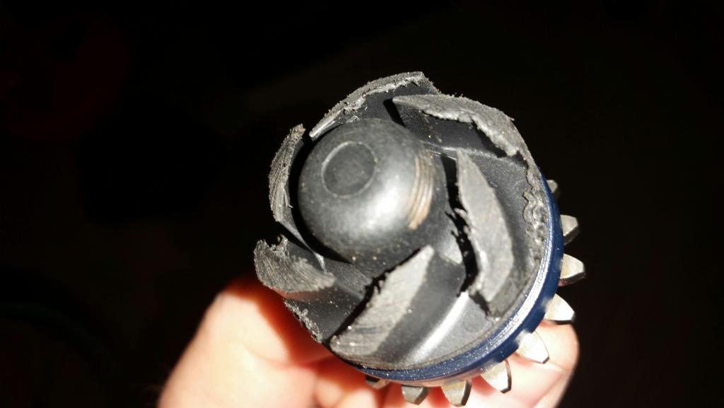

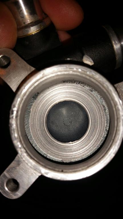

I dont think you can unless you destroy the waterpump...which I did as I knew it was done for and had a new one. The gear is a heat fit which is dropped on the shaft after the circlip is installed but if you heat the gear you may affect the seal.

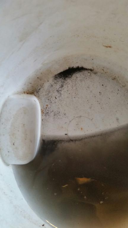

My suggestion would be to put a gasket between and retry to see if the noise goes away before doing anything drastic. The lack of bits in your coolant would seem to indicate that the impeller is not worn away like mine was.
