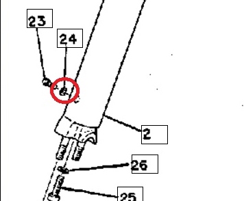

TY250/175/80 fork drain o-ring size?
Trying to source these without paying $2.50/ea from the dealer. Anybody know what size they are? The ones on my bike are all squished or I'd just measure mine.

1st the price should be around $1.00 in the US. 2nd, it's not really an o ring it's a '' gasket '' , I have one in the bag in front of me as I write this PN 122-23129-00. It's made of a kind of plastic, flat on both side, I won't take it out of the bag, being so small, I'll never find it when I'll need it. From what I can tell it's 1.5 mm thick, center hole is 4 mm and of is 7 mm.

Ah - so that's how they're supposed to be. Probably just use the old ones then since it didn't leak. Thanks fellas.
