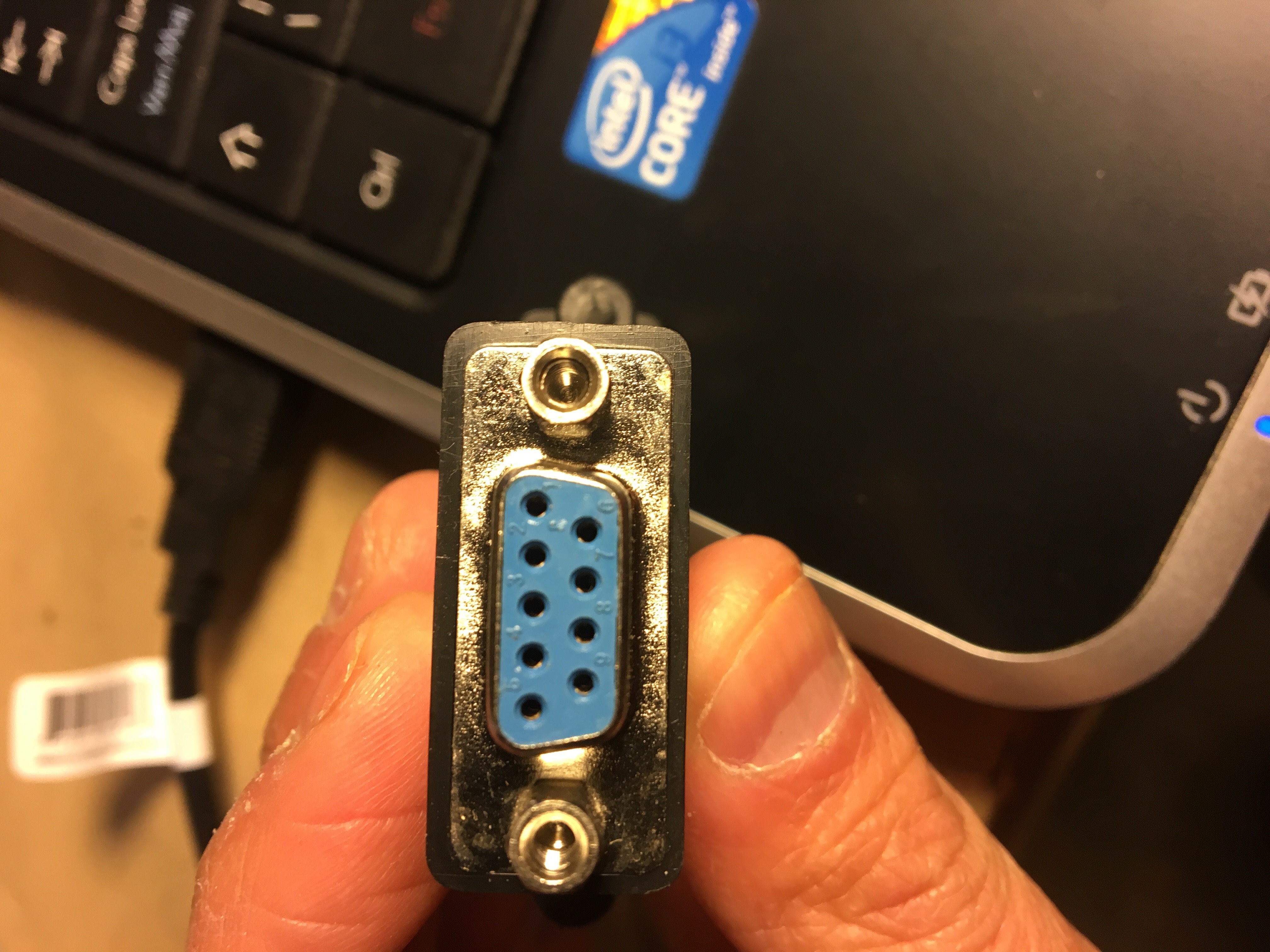

Hey Guys,
Actually, I tried tonight and found out: (1) my cable is actually not "Serial" but a smaller one (see pic below), I was confused with its name but can't remember how's it called, (2) good news my PC has one of those (female) ports as well, and (3) the problem with the current USB-cable seems to be the PC-Driver for the adapter to USB (according to the device manager in windows).
My Windows is 7 home edition. I downloaded a couple drivers for the USB-adapter from internet with no success (after about 1 hr battle)... so plan B is to get a "male-to-male" adapter for the terminal on the pic below and plug it directly into my PC eliminating the USB adapter. I hope that works...
BTW, I'm in Canada too (Calgary).
It won't, the smaller port is the vga out port which is for video or plugging in an LCD projector
If you specify a com port number on your computer you must also set the same com port on the software and then plug the USB into the same port each time. When I did this I selected com 5 and it always works as long as I use the same USB port on the laptop. Is I plug into a different USB port it does not work as it is looking for com 5 on a different port
the more I look into this I begin to think that it is really just a windows 7 issue. Do you know anyone with a laptop running XP that you could try? I would be interested to know if it just fired right up on XP
Canada280i - you're absolutely right... my PC's port is VGA...  yesterday I tried the three drivers from the website link you sent and it hasn't worked so far... so it may be the OS/Windows 7 (?)

You cannot use HDMI or anything like that.
  You have to have a WIN7 driver for any USB to serial. I've had issues anyway for a lot of those, even in XP.
If you have access to a Dell Latitide, use one of these. I'm sure it will work.
http://www.dell.com/en-us/shop/dell-e-legacy-extender/apd/430-3115/pc-accessories
It has a real serial port and works really well.
 OR another HD with XP and a proper drive. Belkin made an adapter that worked well. It requires electronics, you can NOT  just use a wire.  The point about the COM port matching in the hardware and software is very important. Do you know how to set that?
