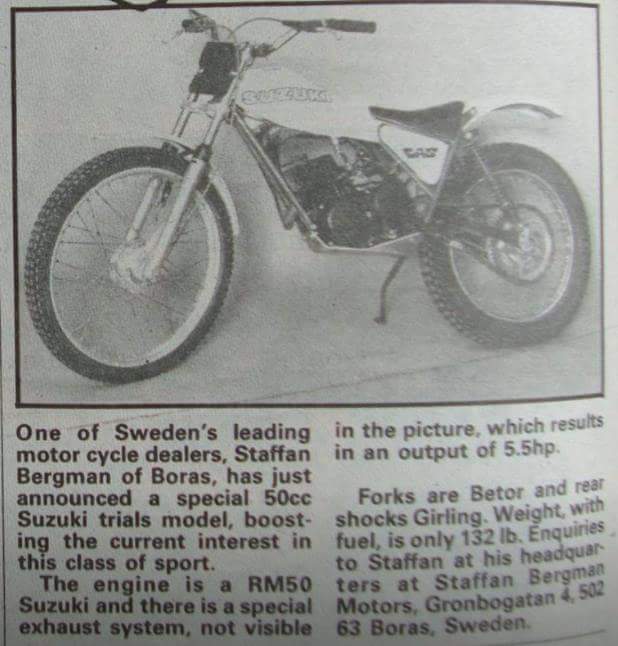

Thanks, it seems that the RM / DS engines were used on low cc trial bike's.
Will look around some more
