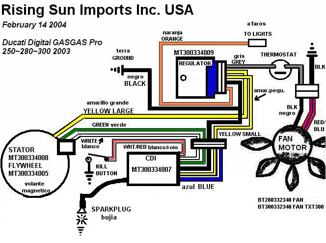

bikerpet Posted December 18, 2017 Share Posted December 18, 2017 (edited) This is another no-spark problem. I've done a fair bit of searching and found various references, but I'm still missing information that I'm hoping others can provide. Background - secondhand 07 GG TXT Pro 250. Been going OK for the past few months since I've had it, starts pretty easily. About a month ago I fitted lights (GG original headlight, LED tail/brake. Fitted my own wiring rather than try to sort through the various existing connectors) ready to get Recreational Registration on it, all seemed OK. Yesterday I fitted an additional LED number plate light. Tested OK in the garage. Yesterday I went for a ride (more of a trail than trials ride). Dropped the bike (low speed, very minor) and found the carb overflows loosing lots of fuel after standing it up. Hard to start. Rode a bit further and found it tended to die/miss a bit when popping the throttle for logs. Stoped the bike to help my son and couldn't get it to start. When I checked the fuel tank I found the breather had locked closed and lots of pressure in the tank. Topped up tank to be sure. Bike would fire a few times then die. Eventually gave up and walked/towed the bike back to the long descent. Once rolling downhill tried roll starting. At first it would fire once, then it gave up totally. 1/2 km of roll start attempts at good speed downhill but nothing doing. Trailered it home. Checked it at home, no spark. So far I've tried: New plug disconnect kill switch disconnect all lights check HT lead resistance (7.3 Kohm) check trigger coil resistance (259 ohms) check trigger voltage spinning engine with drill (1.5 Vac - this seems low?) check yellow (main windings) stator wire to ground (1.2 ohms) check voltage from yellow wire when spinning modest RPM (500?) (15V) removed regulator from circuit and connected yellow from stator to yellow to CDI (these are direct connected internally in the regulator) removed the potting from the back of the regulator to check the diodes that are reported to fail, there was some slight discolouration on the potting in that area (both check OK). I have an ignition that matches the 2003 Ducati Digital diagram. I've found various posts that give resistance and voltage figures for the ignition with two sets of stator windings, but not for this version. So now I'm a bit stuck. I don't know how to isolate the problem further. I'm suspecting one of the following: Trigger coil faulty - the references to the early version ignition suggest the resistance should be higher than I'm reading.Jim Snell mentions these are the most common failure in these systems. CDI/coil faulty - others indicate this is the most common failure. Regulator faulty - currently trying to work out how best to test this. Doesn't seem likely given that the bike wont go even with the regulator totally bypassed. Trouble is I really don't know how to test these to isolate which is giving the trouble. Or I'm missing something and it's something else :-) In the interest of helping others, here are other links I've found that help shed some light on this problem. Regulator diode repair - I believe the diodes are p600 power diodes, but someone else might verify that. Resistance readings (older style ignition) Jim Snell on revisions not actually useful for diagnostics, but sheds some light on what's out there. Pickup coil meter readings and replacement The Hell Team resistance chart Edited December 18, 2017 by bikerpet Added links 1 Quote Link to comment Share on other sites More sharing options...
petert Posted December 18, 2017 Share Posted December 18, 2017 Know it doesn't help with your Ducati system but I threw mine away and replaced with the Kokusan system and never had another problem. I note the tank breather was blocked, have you tried starting with tank cap off the bike? Wouldn't be the first dodgy breather I have heard of! Quote Link to comment Share on other sites More sharing options...
peterb Posted December 18, 2017 Share Posted December 18, 2017 There were many problems with the Ducati systems on the GG trials bikes, and like petert above, we replaced quite a number with Kokusan and never looked back. Most of the problems I have seen were with the regulator, the aluminium cased unit, which if you look at the green potting underneath, you may find a brown discoloured over heated area which invariably is a sign of a component that has cooked. The regulator would need replacing. There were two types, identifiable by having a black or a blue connector. I think one was for the 300, I don't know which colour though. Are you able to borrow another regulator to try out? If you are in the UK, then GG UK should be able to help with this part. Good luck. Bye, Peter B. Quote Link to comment Share on other sites More sharing options...

bikerpet Posted December 23, 2017 Author Share Posted December 23, 2017 Thanks for the replies everyone. I took a punt on the advice of The Hell Team and bought a new coil/ignition unit. Problem fixed. My old unit was way off the specs given in the Hell Team resistance chart - mostly way high (double or triple) so I figured this was the likely culprit. Interesting to see that it seems split between people who report the regulator being the common problem and others saying the coil/ignition unit gives trouble. Sounds like both have their flaws! I'm now gradually digging all the green potting out of the old ignition unit to see if I can find the faulty component - at the price of these things I can invest a few hours in research! If anyone has already investigated this I'd love to hear from you. If I eventually clean it up and find a faulty component I'll report back. It's not particularly hard digging it out - cut apart the black case then with a plastic chisel quietly dig away. Not sure my electronics skills will be up to isolating the fault if it's not obvious though. Quote Link to comment Share on other sites More sharing options...
