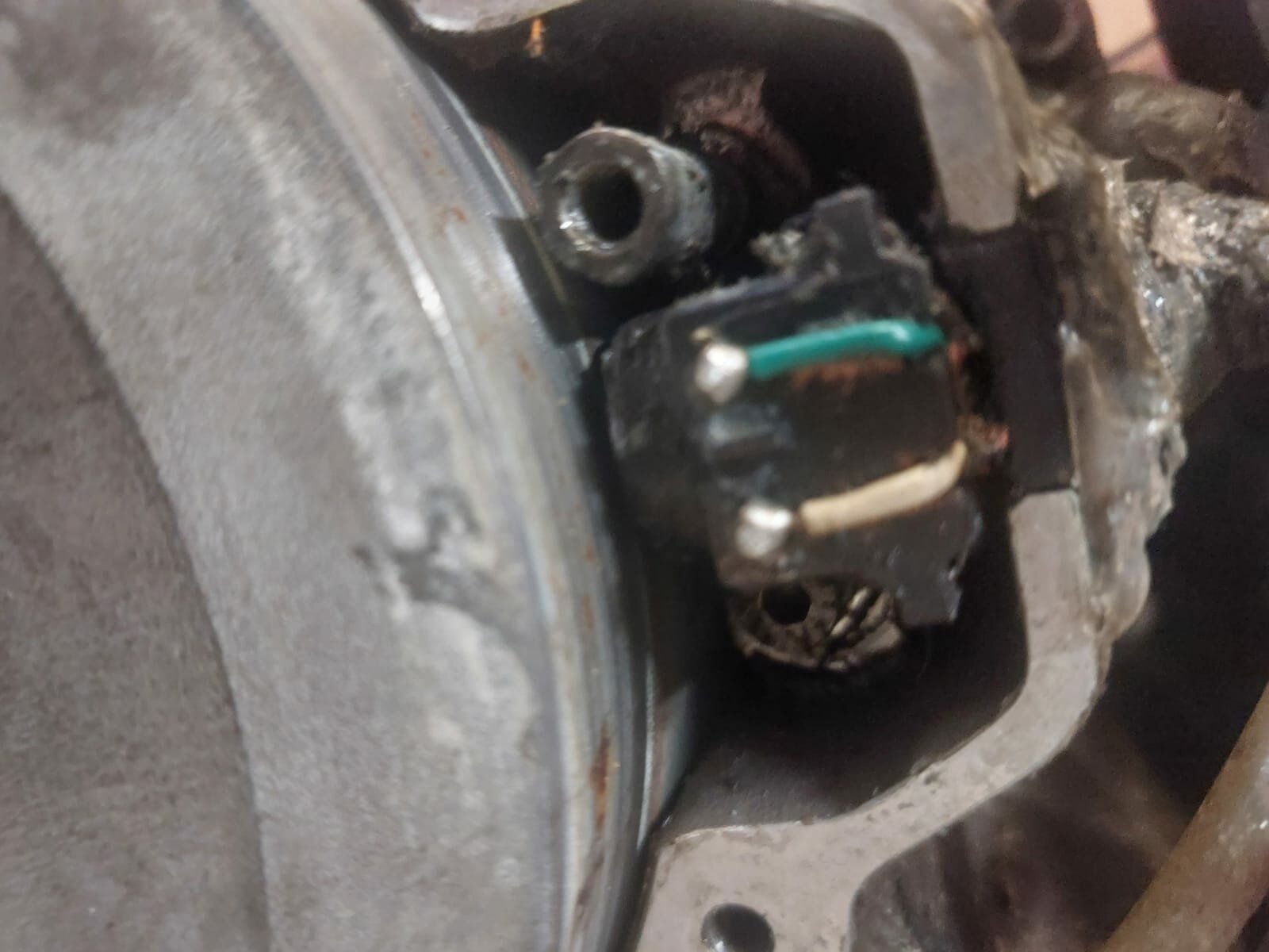

Can someone please tell me what resistance to expect on the pick  up coil fitted with the ducati system?
