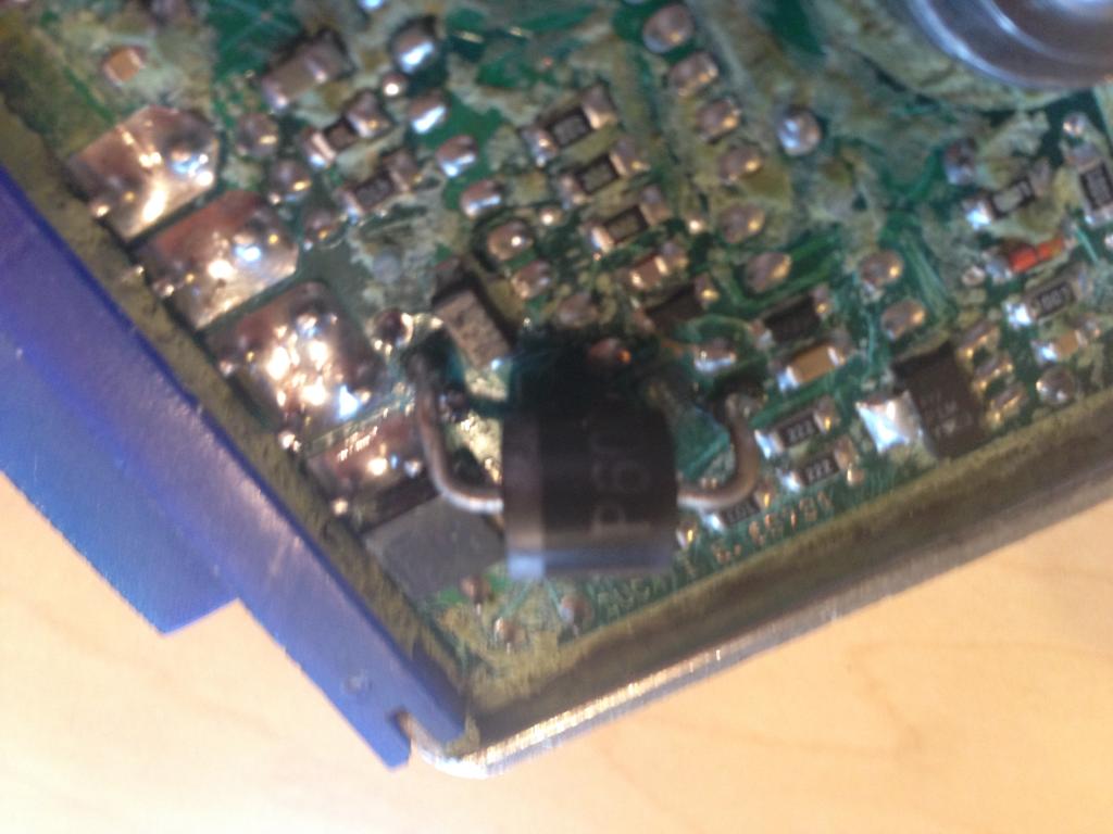

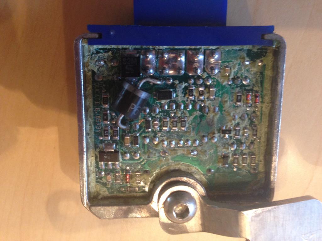

Revisiting this issue for those who may benefit. With the help of my electrical engineer brother-in-law, I've attached a replcement rectifier diode in place of the burnt out diode, bypassing the failed printed circuit. So far the repair has been a success. More time is needed to verify longevity.
Thanks for the tip! I have a couple of burnt out rectifiers that I will try this on. A 35 cent diode is much better than $200 for a new box. I moved my rectifier to behind my numberplate to keep it cooler so it won't burn out again.
Is this still working for you? What did you use to re-seal the circuit board?
Yes, still working. The initial repair was sealed with bees wax so it could be removed if the repair failed but the heat from the radiator melted the bees wax. It was then cleaned and re-sealed with silicon If I remember correctly. My son-in-law has the bike and he did the re-seal.

I think I'll try the $0.35 diode first...it's pretty obvious on mine which one burned out and will replace both while I'm at it. i think radioshack sells a circuit sealing lacquer spray. Maybe I'll seal it first with that then fill with silicone rtv (I don't know how silicone would affect any electronics). The actual potting/encapsulating epoxy is expensive stuff!
Note that the diode is directional. Installed the wrong way it won't work. Check that the RTV is approved for electrical components.
