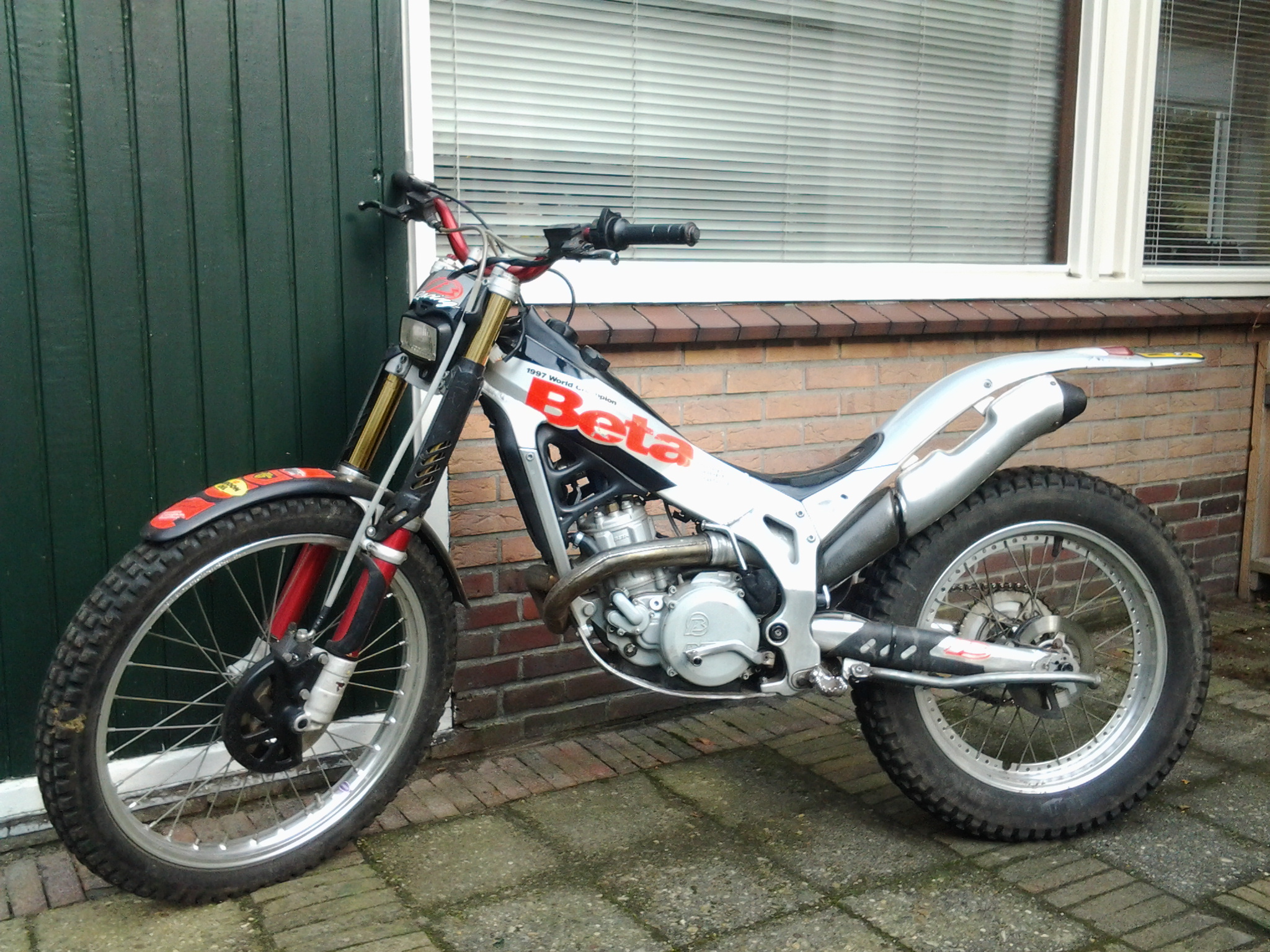

I know that this seems like a pretty farfetched question for a starter on the board, but modifying is a older hobby than trials riding, I would very much like to upgrade my old Techno, because the bike itself is in very good nick!
-  Because the brakes are complete rubbish, and i would like to have a 4 pot caliper, can anybody confirm the fitment of the (see picture 4pot braketechs?) on the exsisting Paioli fork? and with     the current brakedisk?

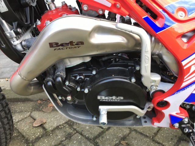

- In the future i would like to upgrade to the Titanium expansion header/muffler of the EVO 250, (and Keihin PWK28) to get some more torque out of the system, does anybody know if the boltpitch and angle of port of the cylinders stayed the same?? I know that REV3 and Techno are almost identical in engine, it could be that they have not changed alot afterwards to EVO, Italians stay at a good plan rather than change it like Honda does every year.

The pipe will never fit. You are wasting money on the new 4 pot as they are mostly junk. Get a used AJP set off a Rev model. (I just put a 10 year old set on my 2016 as the braktechs are junk.)
 Al  your stock parts can be made to work. They worked when new If you want to change the motor, then lighten the flywheel.
