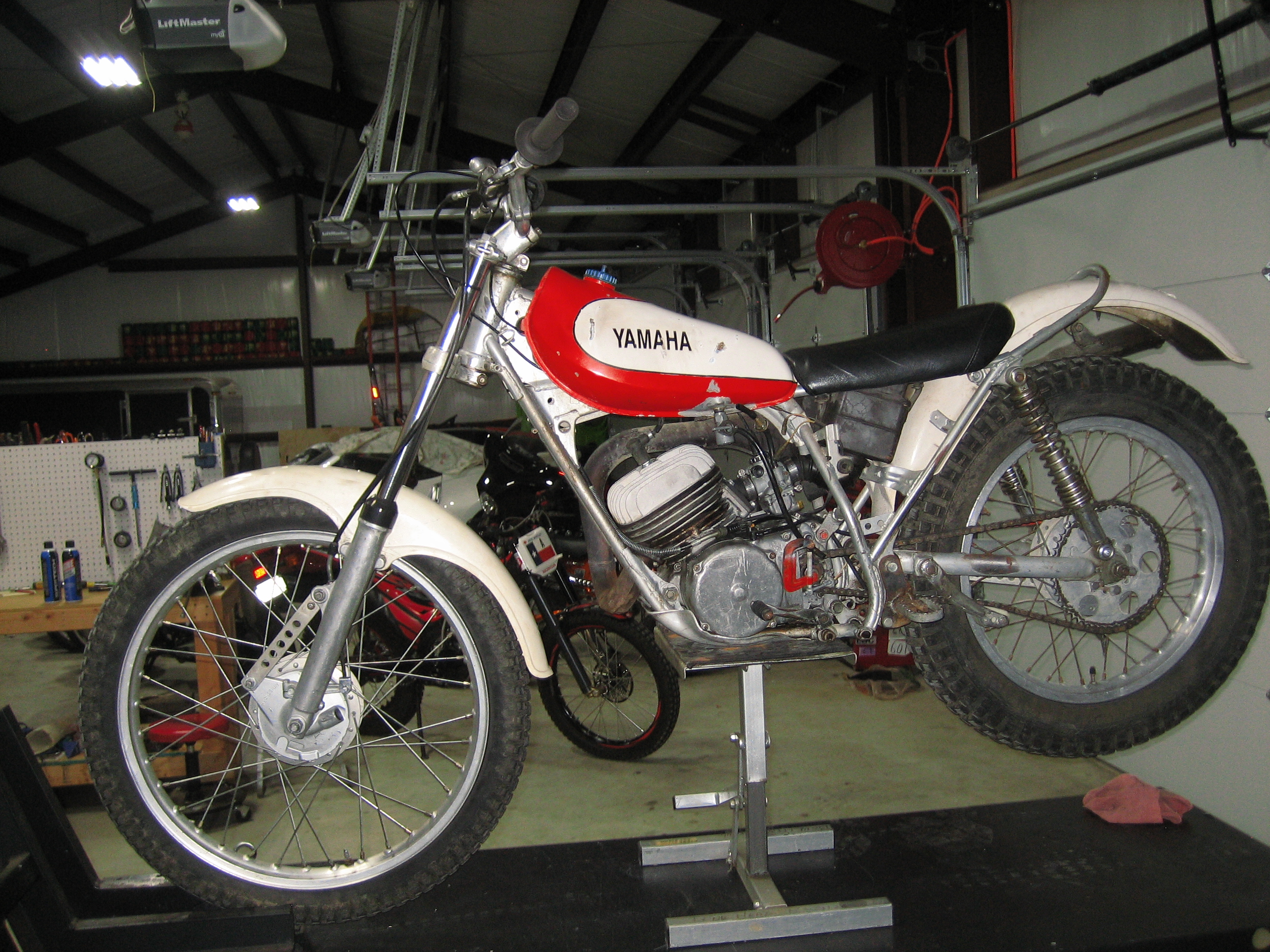

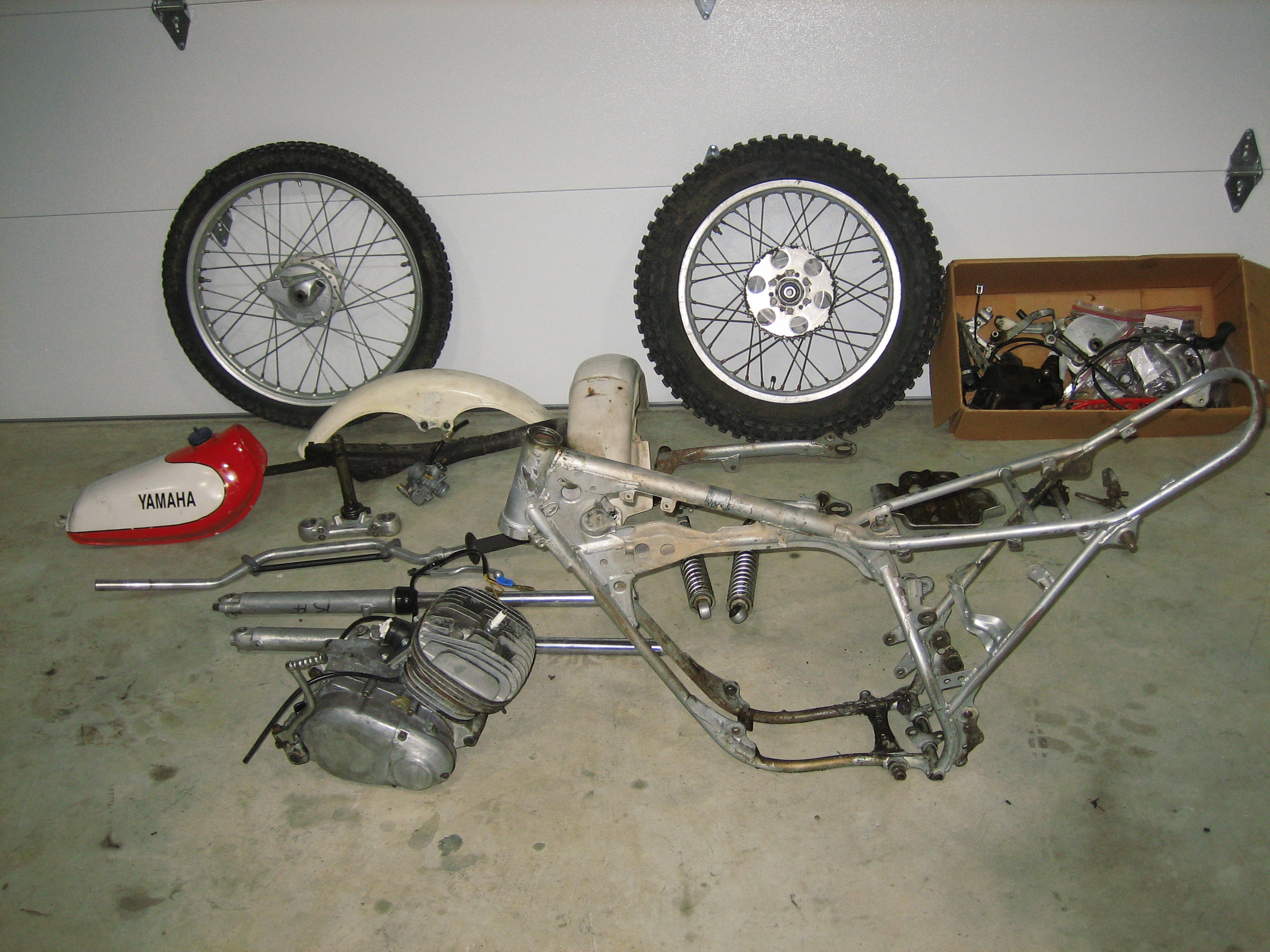

Greetings, I am starting the restoration on my bike and I would like to do some modifications. I have a complete TY250 front end that I would like to use, is there anything I need to do or modify? I appears that it will fit easily. I also plan on putting new shocks on it. I'm leaving the mounts stock so can you give me a recommendation for shock length and spring weight for use with the 250 forks? (I weigh 205 with my gear on) I'll be posting pictures of the build as it progresses. Thanks in advance.
