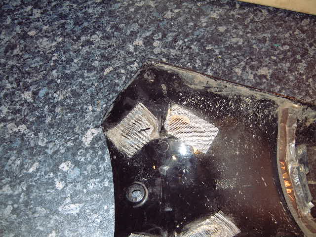

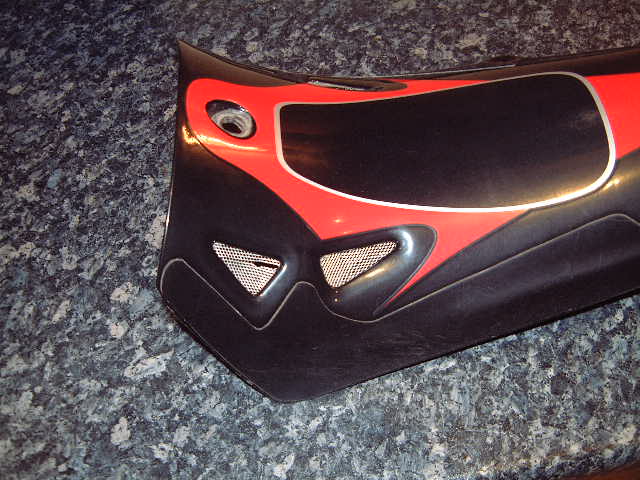

On the vents, here's my rear guard with the P.38 mesh
And from the back - not quite as neat but works !
Edited by Subira
this is how i do mine
the foam is fish pond filter foam. to make it better i am going to make it into a square to go across the front.
also make sure you have the black foam seal you can see inside the rear fender!
